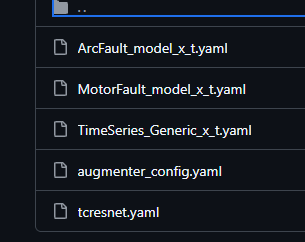

My customer wants to change char pattern (not 0-9) from Char recognition in MSPM0G5187 reference design.
I check below.
https://github.com/TexasInstruments/tinyml-tensorlab/tree/r1.2
for 1, customer can modify below file.
https://github.com/TexasInstruments/tinyml-tensorlab/blob/r1.2/tinyml-modelmaker/examples/MNIST_image_classification/config_image_classification_mnist.yaml
for 2, I cannot find the example for char recognition or I miss something.
can you show me where I can find it?
BR,
frank
  • Hi Frank, I see that the customer wants to modify the input parameters of the model.
    There is no specific example that exists for changing the model parameters in image classification. They can use the screenshot that you have shown in 2, and modify any of the parameters of the image classification model such as:
    input_features=(28,28), variables=1, num_classes=10, with_input_batchnorm=True
    This can be a part of the yaml file like the ones in your second screenshot. Once you have created this file, say "model_config.yaml"; you can use this config in Line 27 of  the https://github.com/TexasInstruments/tinyml-tensorlab/blob/r1.2/tinyml-modelmaker/examples/MNIST_image_classification/config_image_classification_mnist.yaml
    And then use it as model_config: /path/to/model_config.yaml
