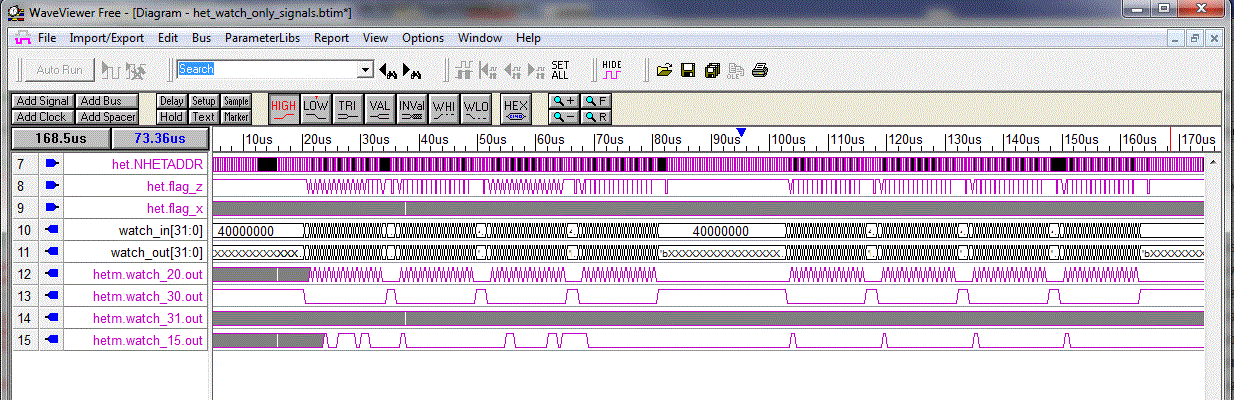

  • So yes it is possible to do what I want to do, except that I've encountered problem or misunderstand how the SHFT instruction works.
    I use the following NHET program to shift out 8x registers of 25-bits each, as 25 bits is the max data field size for the SHFT instruction. However, as shown in the figure I obtain some inconsistencies in the output and can't understand why. Between the first register 0x01C0799 and the second register 0x11C38CC, I got an extra '0' bit. Between the second register 0x11C38CC and the third register 0x1E03807, there is a missing '0' bit, and so on ...
    Please shed some light anyone?
    L00 CNT     { next=L01, reg=A, max=0x01FFFFFF }
    L01 SHFT    { next=L00, pin=CC6, smode=OL0, cond=UNC, cond_addr=L02, data=0x01C0799 }
    L02 MOV64   { next=L00, remote=L01, pin=CC6, cond_addr=L03, data=0x11C38CC, reg=NONE, comp_mode=ECMP }
    L03 MOV64   { next=L00, remote=L01, pin=CC6, cond_addr=L04, data=0x1E03807, reg=NONE, comp_mode=ECMP }
    L04 MOV64   { next=L00, remote=L01, pin=CC6, cond_addr=L05, data=0x003CCF3, reg=NONE, comp_mode=ECMP }
    L05 MOV64   { next=L00, remote=L01, pin=CC6, cond_addr=L06, data=0x0783870, reg=NONE, comp_mode=ECMP }
    L06 MOV64   { next=L00, remote=L01, pin=CC6, cond_addr=L07, data=0x03CCF33, reg=NONE, comp_mode=ECMP }
    L07 MOV64   { next=L00, remote=L01, pin=CC6, cond_addr=L08, data=0x180E000, reg=NONE, comp_mode=ECMP }
    L08 MOV64   { next=L00, remote=L01, pin=CC6, cond_addr=L08, data=0x0000000, reg=NONE, comp_mode=ECMP }
  • OK, the real question is: why the SHFT instruction jumps to the conditional address when its data field is all "1" or all "0" (25 bits)?
    As such, it can never shift out all 25 bits of data field because sooner or later, it will jump before the end of the 25 shifts, simply because any number will terminate by either an "1" or a "0".
    Please clarify.

    Additional to the above post, I am looking for the answers to the following questions:
    Can I configure the NHET to shift out exactly 25 bits from the data field, all the time, regardless whether there are "0" and/or "1"?
    I have observed that, since I use "smode=OL0", NHET left-shifts out msb and right-fills with "0". Once the last "1" in the 25-bit data fields (not all 25 bits if one or more lsb are "0") is shifted-out, an additional "0" bit is shifted out before conditional jump. How can I prevent this additional "0" in the output?
    I need to understand those NHET behaviors because I use the NHET to shift out a controlled number of bits with exact timing (500 ns/bit).
    Thank you for coming back to me.
  • Hi Chuck,
    For your first question of cond jump on all 0's or all 1's, yes, it is the intent of the shift instruction.  you can see the micro-code description on page 1382 of the TRM.
    Reason is that the shift instruction will also result into either shift in 0 or 1 to shift register when shift instruction is executed, thus, when all 0's or all 1's it means the shift is done for this data.
    For your second question on continuing to shift data out when data is all 1's and all 0's, unfortunately the shift instruction does not allow this.  It will jump to conditional address because it thinks that all data has been shifted out.  can i ask why you want to shift out all 1's or all 0's?  Is it to control the CS and SPICLK when you are done with SPI transfer shifting? If this is the case, there is a way to handle this.  Please see attached picture that show the result that i am able to drive SPICLK low and CS high after 4 consecutive SPI transfers were done.  if this is what you want to do, i can send you the example codes.

    Thank you for your suggestion on the SPI example using the NHET. For my use, the 3 built-in SPI are enough for the purpose. Rather I want to use the NHET to shift out a simulator Manchester encoded data stream to our hardware Manchester decoder for loopback testing purpose. As such we have to control the number of bits at the exact timing, and exact bits patterns.
    Given this SHFT instruction limitation or "feature" is you want to call :), I manage to do it anyway. For this, I have to carefully partition the desired output data stream by breaking always between an "1" and a "0", so when the SHFT shifts out the last one, it will insert a zero on the next NHET loop, so I have to start the next data field without the "0" of my bit stream.
    For example, if I have to shift out "xxxxxxxxxxx1001xxxx", I have to break it as follow: first data field contains "xxxxxxxxxxx1", after this is done, the data field have to be updated with "01xxxx" because the first zero is inserted by the SHFT instruction.
    I still don't understand why the SHFT was designed this way, why not just clock out 25 bit, any value then stop? For what application was it designed for?
    Not really looking for an answer but just curious though ...
    Thanks again Henry.
  • Hi Chuck,
    the SHFT instruction was designed as a self-counting instruction when shifting out or in data.
    when all 25-bit data is shifted in or out (all 1 or all 0), then it can branch to conditional address to either move data into internal buffer for shift in case or reload new shift out data.  This can be done without a CNT instruction.
    to get around the feature, one can implement a CNT instructions as:
    CNT (from 0 to whatever number, e.g. 25)
    BR (event=z, cond_addr=reload or move to buffer, next=shift)
        shift (in or out, cond_addr = next address = to CNT )
    this way, even if your data field is 0 or 1, it will shift 25 times according to your protocol.
