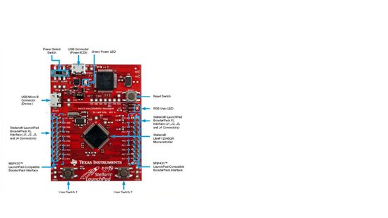

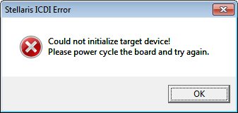

Hi.
I am using a stellaris LM4F120 LaunchPad Evaluation Kit on a windows 8 PC. When I start a debug session with the latest Keil verion(4.72) its automaticly stops and return to the editor.
I have tried with several stellaris kits, and with example projects. I have unistal and reinstal keil and i can´t debug.
Thanks.

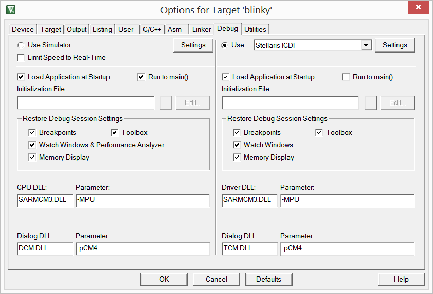

    2) What version of Keil are you using?  Can you send screen shots of the properties tab for the Debug and Utilities tabs?
    3) Can you send a screen shot of the driver details for the Stellaris ICDI DFU Device and the Stellaris ICDI JTAG/SWD Interface?
    Thanks.
  • 1) It seemed to finish loading the code, switched to debug view then switched back to edit view immediately by itself.  I lost three LaunchPads (one EK-LM4F120XL, two EK-TM4C123GXL) after that.  They are not responding to Keil anymore, not even in a Windows7 system.  When I plugged in these three boards to my Windows7 system, the drivers came up but when I tried to debug in Keil, I got
    The DK-TM4C123G survived.
    2) I used Keil v4.72.10.0 and v5.0.5.15.  Both exhibit the same problem.

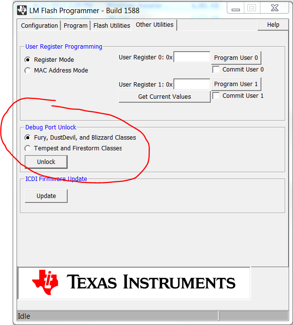

  • I have uninstalled and reinstalled LMFlashProgrammer and ICDI drivers.  I have also uninstalled and reinstalled Keil and also change Keil from v4.72.10.0 and v5.0.5.15.  Neither fixed the problem.  I am not ready to wipe out the HD and reinstall Windows.  I don't believe that is an acceptable solution for my students.

    I've not been able to kill any ARM MCU via proper, "normal/customary" JTAG or SWD input - even disordered (outside time or position spec.)  (assumes signal levels are all constrained to V spec)  I don't believe your misbehaving boards are, "fini" - suggest that you properly store/handle (ESD Safe) & I bet - in time - we can restore/recover...
    Developing methods to "speed" the onset of this issue appears critical - I have further ideas in that regard (did just that to overcome size/finance advantages of past competitors) - and believe my earlier writings offer a sound beginning...

  • Thank you for providing the screen shots of the Keil properties.  As far as the debug selections within the tools it appears the drivers are selected correctly and the fact that you can download code seems to indicate the ICDI might be ok.  In addition, we have been unable to change the behavior of the debug using any of the Windows permissions in an attempt to duplicate the issue.

  • Hi Shujen,
    Relating to your picture: can you repeat the programming and when got the error message, go to configuration tab and snap that window instead of the starting one. My question: did you selected the right clock source for your microcontroller in that tab?
    Petrei
  • Petrei,
    This is how I interpret your request:
    Relating to your picture: can you repeat the Flash Erase with LM Flash Programmer with the unresponsive Tiva LaunchPad and Windows 8.1 and when got the error message, go to configuration tab and snap that window instead of the starting one. My question: did you selected the right clock source for your microcontroller in that tab?
    The clock source is fixed when I select TM4C123G LaunchPad.
    It is OK; a big number of users neglect these settings and the resulting message is the same. I do not use W8...
    Petrei

    When I tried to erase these three LaunchPads with LM Flash Programmer, I am still getting "Unable to initialize target -0!"  When I tried to use Keil to debug the board I got
    When I click on OK, I got this:
    After that, Keil is still working with the new boards.

  • When you used LM Flash Programmer to erase the part what steps did you use?  Did you try using the JTAG Unlock?  If not can you try this to recover the boards that are unable to connect and let us know if that works?
