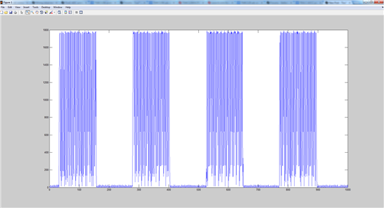

Hi people,
When digitalizing a 300 Hz square wave with a ADC triggered by a timer at 50 KHz, I don't get a pure square wave.. I have got a lot of glitches (several VCC to almost 0 transitions).
I am using a TIVA C TM4C1294XL evaluation kit.
The ADC is configured with a sequencer 3 and triggered by a 50000 Hz timer:
    My read is that the ADC is triggered @ 50KHz - not that 50K ADC samples have been collected...
    At that rate - samples are collected @ 20uS intervals.   Dumping this data - via any serial port - is unlikely to keep up with this data rate - is it not?
    It's annoying for posters to burden their code w/extensive "commented out" lines/regions - demoralizes & slows the reviewer's task.   (and is not especially considerate/thoughtful - i.e. client values their time/comfort beyond that of their unpaid/hapless helpers! )  (even the paid helpers (Amit) should be treated w/care/consideration)
    I'd prefer to see the actual sampled data collection (raw) rather than the "hidden source" graph - we're asked to "trust" that all graphing ran successfully/smoothly - while the main ADC process did not...   (seems bit of a stretch...)
    In such troubleshooting - KISS always rules/runs our attempts.  If 50KHz fails (as it clearly does here) is it not useful to run at a far slower rate?  (say 5KHz?)  As success reveals - only then - "bump up the conversion rate" - until the system again, "runs amuck."

  • Hi again,
    I found the bug , it was on the PC-side , everything is working now.

  • Hello again,
    Excuse me since it was the first time that I'm posting something on a forum.
    The firmware is working good.. It acquires X samples, stores them in RAM, and at the end sends it to the PC. To reduce the overhead, sends everything in NON-ASCII (thus, 1 sample = 2 bytes)..
    The problem was due to the matlab function dec2bin which when concatenating the two nibbles, omitted the 0's on the left of the least significant nibble, decreasing the value.
