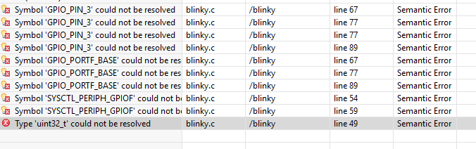

  • Hi Amit

  • Hello Gaurav
    You need to include the file "inc/hw_types.h"
    Also please make sure that the include file path is defined.
