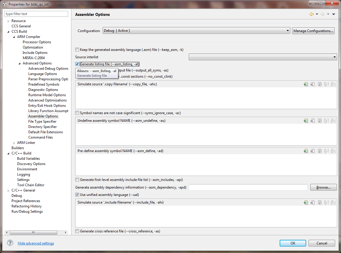

    Turn on debug assembler listing to witness 3rd party calls by CCS compiler (7M4eabi.lib):
