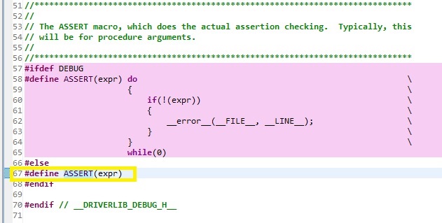

    // The ASSERT macro, which does the actual assertion checking.  Typically, this
    // will be for procedure arguments.
    #ifdef DEBUG
    #define ASSERT(expr) do                                                       \
                             if(!(expr))                                          \
                                 __error__(__FILE__, __LINE__);                   \
                         while(0)
    #else
    #endif
    #endif // __DRIVERLIB_DEBUG_H__

    Now there are compile time asserts defined in C11 but not many compilers support C11 even yet, I don't know how many support the compile time assertions. That would involve the use of the macro static_assert. However, that has limitations as well since it can only work with compile time constants.
    BP101 said:
    The compiler will post a warning or even an error if priority value passed into IntPrioritySet() is not any one of the 8 values listed.
    Really, got a screen shot of that behaviour? A call to IntPrioritySet where an assert causes a compile time error. Only compiling the one source file (and associated headers) not the library?
    BP101 said:
    LWIP1.4.1 TCP protocol configurations are set to warn/inform users of ASSERT tests of misconfiguration during compile time.
    Pretty sure that's not using ASSERT but rather IFDEF and a few cousins. It's possible they've started using static_assert, I'd like to see an example if so.
    This type of checking though, will not provide for argument checking.
    Now if you do have a small set of valid values and rather than a bare type or sized type (as TIVAWare uses) you use a typdefed enum with the limited values then a good compiler can catch invalid values. It was a poor implementation decision not to use anything other than sized types in the TIVA library IMO, and this is one reason why, it removes an avenue for simple error prevention early in the process.
    Robert
  • Robert Adsett said:
    Seriously? They are modeled after the C standard asserts. They are only present if DEBUG is defined. They provide no protection otherwise
    Exactly Tivaware declaration asserts are not meant to provide protection in the runtime binary object only compile time checking.
    The asserts in the declaration area of Tivaware functions are not part of the output binary object and never show up in debug disassembler view. Those asserts are invoked only during compile time to check the passed variable for correct length during compile. There are no SW exception handers built into the NON-OS platform environment to handle an declaration assert failure. So adding a declaration assert to allow only the values I posted for priorities would be checked during compile time for errors and flag a warning if any value was out of that range..
    Agree 100% about debug runtime asserts being part of binary object yet those type of asserts never seem to be placed in the declaration area of a function and are integral part of the program flow.

  • Robert Adsett72 said:
    You have that exactly backwards. The protection exists at runtime, not at compile time.
    It would seem that is not exactly correct either and I only mention asserts being in the deceleration area for the benefit of Tivaware function IntPrioritySet().
    Asserts are runtime constructs. I even quoted the header declaring them which makes that painfully obvious.
    Macro asserts placed in Tivaware functions are not handled at runtime since they are not present in the binary object output data when Debug is disabled. That case assert macro exists for CCS compiler to validate the configuration variable being passed to the function is in range, but only at compile execution of Debug object. Good to point that out we perhaps should all be sure to disable Tivaware Debug engine in Release object. Past discovered if Debug was left enabled in Tivaware EMAC abstraction layer when the IOT examples SW using that engine was missing a debug handler. The compiler was adding the debug code into the binary object and bus faulting the MCU precise and watchdog was resetting the MCU.
    Again I particularly do not want to ever find Tivaware macro asserts in the compiled binary object being used to set bits in peripheral registers of runtime Release object. CCS compiler has a Problems report tab and posts messages when the macro assert in the function is not passed valid data even when Debug is disabled. Only during compile time does Tivaware function when passed invalid assert data stop the complier from creating an output binary.
    Otherwise a functions declaration macro asserts would constitute (unhandled exceptions) Debug being disabled in runtime object, how do you explain that insane logic?  Yet LWIP has it's own Debug exception handlers when Debug enabled at compile time and Tivaware functions never have macro asserts in the object. So the compiler knows which functions the assert macros and handlers have ownership.
    When debug is pink the macro is disabled at compile time so the compiler then removes all macro asserts from the binary object. Engineer has to first enable Debug and recompile application so the macro asserts are then added into the binary object.
  • Deceleration area? Pray tell what's decreasing in speed?
    Note that the highlighted (in yellow) code provides no protection either at runtime nor at compile time.
    While the alternate code provides protection only at runtime.
    Robert

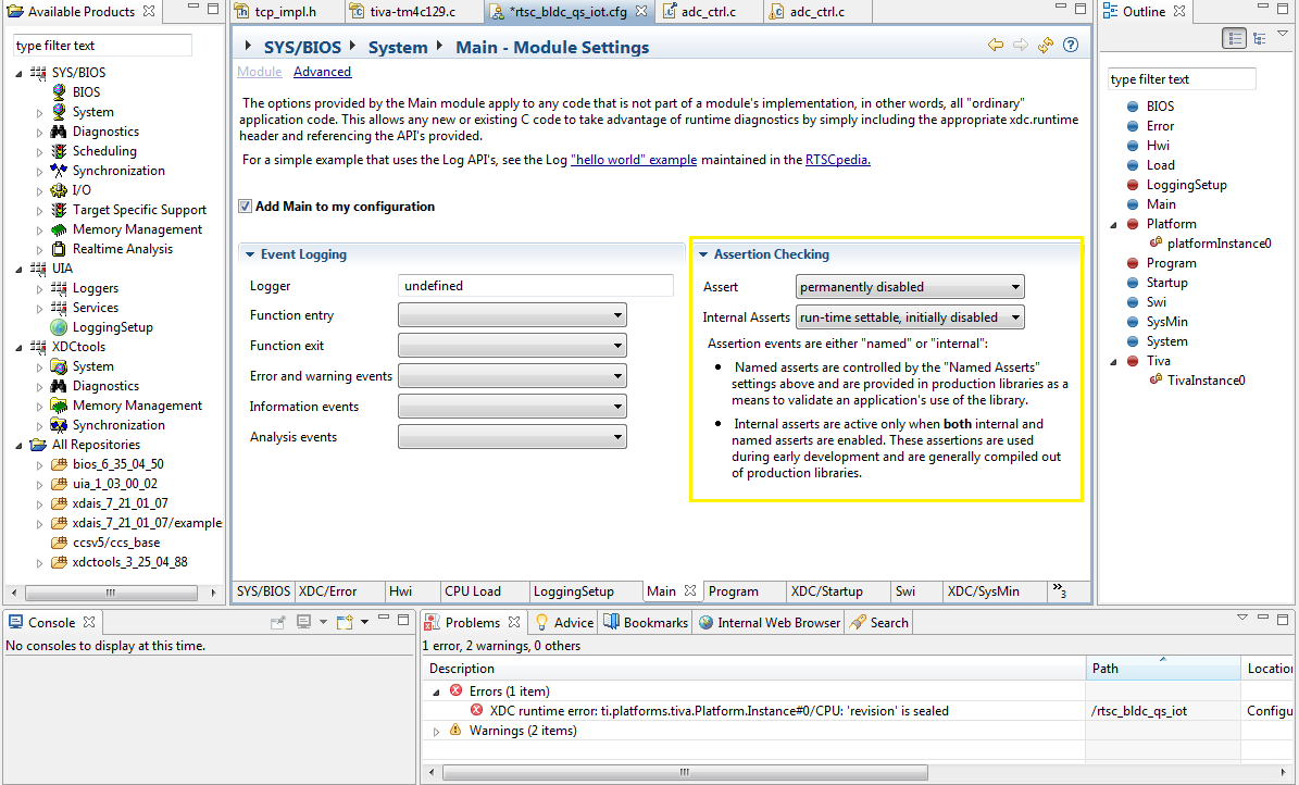

    To funny was supposed to be declaration not deceleration. Perhaps CCS automated code analysis is processing Tivaware function Asserts since being Debug output is disabled in that area of the code. The only debug engine enabled is LWIP and it outputs status file and other status via UARTprintf() into virtual COM port.
    It would make since compiled Release binary we should omit all debug Asserts after SW was debugged order to save flash memory space for platforms such as RTOS or Sysbios.  Again CCS compiler outputs error status in the console and IDE problems dialog boxes only during compile of Tivaware function Asserts to indicate error of any variables being passed into the range that fail the assert constraint. Hard to imagine LWIP debug is somehow causing that since the compiler assert messages never show up on virtual com port terminal output.
    Highly unlikely. It would break code to define the DEBUG macro even just for a code analysis pass. Also the analyzer would not have access to the ASSERTs when it is analyzing the code that would need to be checked.
    I'd like to see that. I don't really credit that statement.
    Robert

    To be clear I was referring to the Tivaware function assert debug messages not the real time syntax validity checker. Spending time with RTSC Sysbios kernel required SWO debug System Analyzer support via program platform monitor of MCU's TMC/APB. RTSC package presents several ways of control over function asserts (yellow box). Seems CCS compilers check for the symbol (Debug) since the only Asserts ever invoked are LWIP related.
    As far as I'm concerned all routine testing and all regression testing should be done with the same flags and defines as the release version
    My thought is why waste instruction cycles for code already proven to work, what good can come of that. Perhaps on a Mars rover but only when signaled from earth to invoke assert debug via kernel task command otherwise watchdog would POR the MCU if fatal SW conditions arise. Static register values set during peripheral initialization if done repeatedly adds to timing overhead, for instance reprogramming ADC sequencer FIFO's via Tivaware library versus making HWREG calls direct to the registers. Sysbios kernel might be a good choice for your style of leave all flags flying debug/release. LWIP 1.4.1 protocols have many embedded asserts but they don't fix any issue rather only reports something bad has occurred. Have seen LWIP protocol asserts swamp UART and USB connected serial VTE so bad ends up faulting MCU. Now only enable and report specific protocols and later in release object will turn off all LWIP debug engines accept invoked heap space reports that use the debug engine.
    [/quote]
    So was I. I never thought there was anything else. Those asserts will only apply within the called function (they are not otherwise visible) and only at runtime.
    I do believe that if you check you will find they are all run time asserts.
    If the preprocessor did not behave in accordance with the definition (or not) of DEBUG then the compiler would have a very, very serious bug and be essentially unusable so I would certainly hope so.
    [/quote]
    What ill can come of it? If it doesn't work with them defined then you cannot test with them defined. If it does work with them defined then there is no benefit in not defining them.
