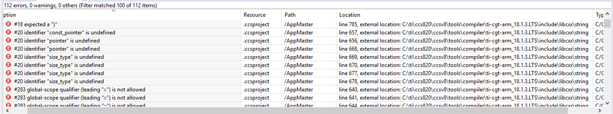

For some reason when compiling with the 18.1.3 compiler, I get the following errors in the log across multiple files:

Error limit reached.
100 errors detected in the compilation of "myfile.cpp".
In the problems panel, I get a lot of errors from the string file in libcxx folder.

  • I wasn't able to create a test case with a single file, and I can't provide you with the full source, of course.
    However, I was able to get it to compile without changing the source code by creating a brand new project, and adding all the source files, and other misc things like the SYS/BIOS config.
    I then looked over the settings to see if anything stood out, but all my settings seem to be properly copied over to the new project, and there don't seem to be any serious differences.
    I'm thinking either I've missed some compiler settings, or some other ccsproj setting that's somehow screwing up the build.
    I did notice that the "builder" element of the new cproject file has the following attributes defined, but I don't think that would make the difference: parallelBuildOn="true" parallelizationNumber="optimal"
    Would sending the cproject files help?
