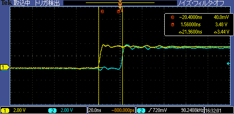

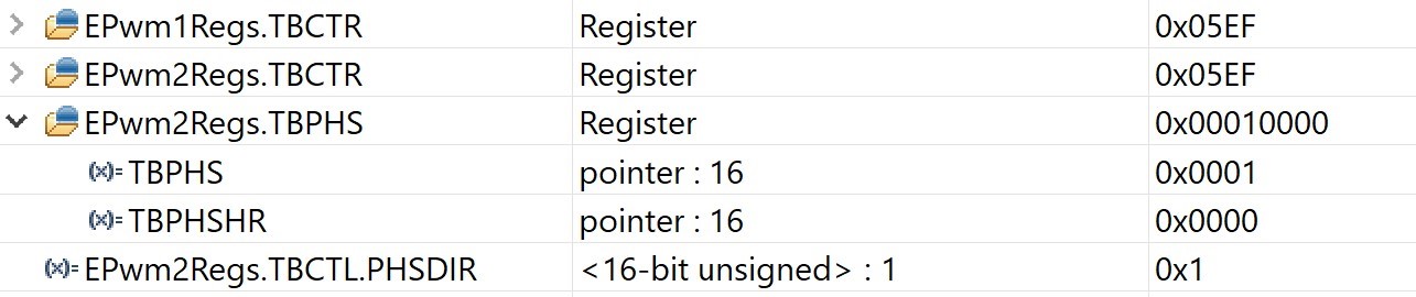

    I tested the example of hrpwm_ex4_deadband_sfo_v8.c in ”… device_support\f2838x\examples\cpu1\hrpwm” with the following changes.
    As a result, 2 PWM cycle jitters occurred. please see the picture and attached C source.
    #define HR_ENABLED          0   // disable HR behavior
     (*ePWM[PWM2]).TBPHS.bit.TBPHS = 0x00; // in interrupt function
    Could you let me know what caused the jitter.
    Thanks.

  • That is expected. Thats not JITTER but the logic delay inside the chip. Please enable the PHASE SHIFT LOAD and compensate the delay cycles in the TBPHS value.
    Nima
  • Thank you for your answer.
    But followings are not clear to me.
    1. Does it mean the logic delay always exists?
    2. Does the logic delay occur in the slave PWM modules from the mater PWM module when using synchronization?
    3. Is the logic delay a constant as 2 cycles? Or the amount of delay depends on the type of the microcontroller individually?
    I really appreciate your help.
    Wenjing
  • Yes there is always a logic delay.
    If you have PHSEN, you need to set the TBPHS value to compensate the logic delay. It's very simple. The delay is in the sync receivers.
    The delay is constant.
    Nima
  • Thank you for reply.
    Yes, I am using the way you mentioned as setting TBPHS to compensate the delay. It is also working fine.
    In my experiment, the logic delay is 2 cycles.
    You replied the delay is constant. Can I understand that the constant is always 2 cycles with C2000 series such as F28388, F28379, F28335, etc. ?
    Is there any document for explaining this issue?
    Wenjing
  • Yes in my code I also had the value of 2, which mean the delay is actually 3! 0-1-2
    Nima
  • Sorry, I did not get your point. Could you make it clear?
    I would be grateful if you could provide any detailed explanation for this issue officially?
    Since this issue is quite important to us.
  • There is a 2 CYCLE delay! Hence, you have to set the TBPHS value to 1. (Remember the counter goes ZERO, THEN ONE!)
  • Thank you. I got it.

  • The values are different for UP-COUNT and UP-DOWN COUNT
    I will add this to the TRM.
    UP COUNT Results
    UP-DOWN COUNT Results
  • You need to set the PHS to 0x1. For both UP-COUNT and UP-DOWN-COUNT.
    Sorry I just tested to get the values. I will update the TRM to reflect these values as I cant find it in the documentation.
    The logic delay is 2. So the phs value must be 0x1.

    But, I tested the example of hrpwm_ex4_deadband_sfo_v8.c in “… device_support\f2838x\examples\cpu1\hrpwm”
     (*ePWM[PWM2]).TBPHS.bit.TBPHS = 0x02; // in interrupt function
    It results I need to set the PHS to 0x2 for UP-DOWN-COUNT.
    It also results the same as setting the PHS to 0x2 For both UP-COUNT and UP-DOWN-COUNT in my experiment.
    Could you double check the example and let me know your test result?
  • You are using F28388 device?
  • Yes, I am using  F28388D.
  • Sorry for the confusion. Yes your experiment is correct. For F2837xD, F2837xS and F28004x device, the delay between EPWM1 and EPWM2 is the 2 cycle delay hence the value written is 0x1.
  • Hi, Nima
    Thank you for confirmation.
    I have 2 further questions.
    1) The example of hrpwm_ex4_deadband_sfo_v8.c, it shows 2 cycle delay between epwm1 and epwm2,
     and It will be perfectly compensated by writing PHS = 0x2. Please see the waveform.
    Does it mean PHS = 0x2 for 2 cycle delay not 3 cycle?
    2)  Is it a fixed amount of delay regardless of the individual of  F28388?
    Wenjing
