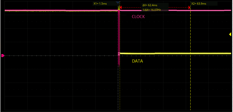

When I testing some of abnormal situation for pmbus slave mode, I found that the CLK_HIGH_DETECTED in PMBSTS won't get set. Can you please help me know why?
My testing condition is that master read block data from slaver, and I made master hold the clock high after reading one byte (not finish reading all bytes). This is abnormal condition for master. But in this condition, I found that CLK_HIGH_DETECTED in PMBSTS won't get set. Please see below picture that capture PMBSTS value via CCS.
Please see my testing waveform as below, the first waveform show that the master hold the clock to high but not finished all reading bytes, slave pull down data line to low. The second waveform shows the last byte that master read from slaver before enter into abnormal situation.
Our customer systems require that the slaver have to recover to normal state(clk and data release to idle) once detecting any of abnormal situation happens including master. Can you share some suggestion in this case? Thanks...

    CLK_HIGH_DETECTED bit should be used by PMBus master and not PMBus slave. According to PMBus specs, CLK_HIGH_DETECTED bit provides a guaranteed method for masters to detect bus idle condition.
    I want to understand how PMBus CLK_HIGH_DETECTED bit affects your slave operation.
    Manoj
  • Manoj,
    Please see my testing waveform in my first post, here I will reproduce it as below. Before the eom of pmbus read block was inserted, master hold the clock high and do not continue to toggle clock to read rest of bytes, and pmbus slaver will hold the data low. This causes pmbus slaver won't recover properly. I need conditions or flags that knows current pmbus slaver works abnormal, then recover pmbus hardware(maybe reset hardware ) and pmbus state machine.
    But there is no extra bits in pmbus status register could tell me that pmbus hardware works abnormal, can you share some suggestions?

    Good point.  This issue actually caulsed by master, the system requires slaver can be recovered properly even master cause transmission abnormal. In this case, the slaver has always pull down data line, it's abnormal. So it's OK to reset pmbus slaver and won't affect master.
    My master is server system.
  • Jack,
    I tried to re-create abnormal condition and also didn't see CLK_HIGH_DETECTED bit get set in PMBus slave mode.
    I have requested design team to confirm whether CLK_HIGH_DETECTED would work only when PMBus is configured as master. If the reply comes affirmative, you might need to implement a workaround along this lines.
    When PMBSTS.UNIT_BUSY bit is set, it indicates that PMBus interface is busy. We can use this feature and a timer to implement a workaround as shown below:-
     If UNIT_BUSY bit stays high with no PMBus transaction then reset the PMBus module.
             – Set up firmware timer in timer interrupt to detect lockup
             – If it times out, reset PMBus peripheral, firmware
             – PMBus firmware clears timer whenever data is transmitted or received on bus (or)
             – when UNIT_BUSY bit is not set (meaning PMBus interface is not busy)
             – Timer interval depends on PMBus host speed
    Manoj
  • Manoj,
    Cool. I see UNIT_BUSY get set under this condition.
    Jack
