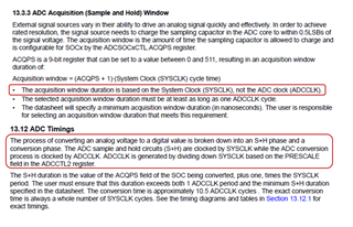

13.2.1 Clock Configuration
The base ADC clock is provided directly by the system clock (SYSCLK). "This clock is" used to generate the ADC acquisition window. The register ADCCTL2 has a PRESCALE field that determines the ADCCLK. The ADCCLK is used to clock the converter. The core requires approximately 10.5 ADCCLK cycles to process a voltage into a conversion result.
It is necessary for the user to determine the required duration of the acquisition window, see Section 13.13.2.
Given the reference of the ADC clock, "This clock is" to me infers the ADC clock, not the derived from source SYSCLK. The 13.2.1 statement is vague misleading one to believe SYSCLK was the acquisition source clock rate and EOC interrupt pulse source. TRM omitting any kind of peripheral main clock tree or any clock source identification ADC block Fig.13-1 is mind numbing.  Adding clock sources in block figures will remove any such question of who is the real clock source. The words "fore mentioned or latter" would infer SYSCLK generates the acquisition window.
Yet 50Mhz ADC sample acquisition rate is not slow by any means and should produce well over 2.5MSPS, upward 3MSPS. The AD converter clocks at SYSCLK speed in other TI family ADC peripherals so the digital FIFO data timing aligns with CPU system BUS timing.
  • Hi GI,
    Thanks for the feedback!  I see the confusion.  Instead of just stating "This clock is" on the next sentence as previous sentence had referred to both ADCLK and SYSCLK, we have to be specific what clock this actually is.  In this case, "This clock is" refers to SYSCLK.  The timing diagrams and tables in section 13.12.1 are all expressed in terms of SYSCLK.  You are correct, SH, EOC and interrupt timings tLAT, tEOC, tINT are all in terms of SYSCLK in the timing diagram.  The conversion result being ready by 10.5 ADCCLKs is factored in on the values tabulated in Table 13-9, hence the different values of tLAT, tEOC, tINT expressed in terms of SYSCLK for the different ADC clock prescaler values.
    And lastly, yes with a 100MHz (10nS) SYSCLK rating for F28004x,  higher ADC throughput can be attained.  This is reflected in the datasheet SPRS945F, where maximum attainable ADC sampling rate is 3.45MSPS (p.1 and Table 7.10.1.2.1).
    Hope this clarifies the confusion.  I have submitted a ticket to have the the statement changed to "SYSCLK is used to generate the ADC acquisition window".  Next version of the TRM should have this wordings.
    Joseph

  • Hi GI,
    ADCCLK is responsible for the quantization/conversion.  SYSCLK is used for SH and used to clock the rest of the ADC wrapper functions (FIFO, interrupts, EOC, SOC control, PPB, timestamps..etc).
    ADCCLK/SYSCLK use is stated in several parts of the TRM as well:
    Would it have helped eliminate the confusion on ADCLK/SYSCLK use in ADC if block diagram included the added clock tree (in red)
    Joseph

  • I think you are assuming that TM4Cxxx ADC is similar to F280049 ADC.  Both are 12-bit ADC but they are entirely different designs.  TM4Cxxx ADC events are all based off of ADCCLK.  F280049 ADC, as described in the TRM operates on SYSCLK and ADCCLK.  ADCCLK is used by the SAR for the quantization.  Rest of the ADC events which include SH, data transfers and interrupts and the other functions done by the ADC wrapper are clocked by SYSCLK.  That is how the F280049 ADC is designed to operate.
