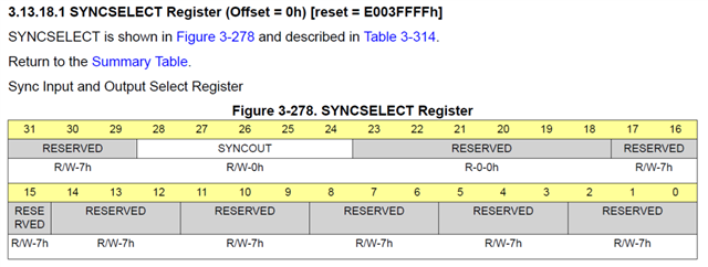

As described in F28002x TRM, there are two SYNCSELECT registers, one is in SYNC_SOC_REGS:

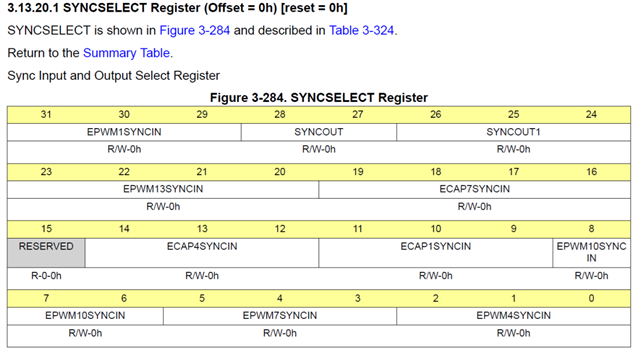

The other is in TRIG_REGS:
In the latest C2000ware, we can only find the first one's definition in "f28002x_sysctrl.h" as below:
struct SYNCSELECT_BITS { // bits description
Uint16 rsvd1:3; // 2:0 Reserved
Uint16 rsvd2:3; // 5:3 Reserved
Uint16 rsvd3:3; // 8:6 Reserved
Uint16 rsvd4:3; // 11:9 Reserved
Uint16 rsvd5:3; // 14:12 Reserved
Uint16 rsvd6:1; // 15 Reserved
Uint16 rsvd7:2; // 17:16 Reserved
Uint16 rsvd8:6; // 23:18 Reserved
Uint16 SYNCOUT:5; // 28:24 Select Syncout Source
Uint16 rsvd9:3; // 31:29 Reserved
union SYNCSELECT_REG {
Uint32 all;
struct SYNCSELECT_BITS bit;
Would you please help how to configure the second SYNCSELECT register? Thanks!
