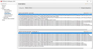

Hello there
I am working on the TMS320F28069, I have debug the program and it went perfectly fine, there is no issue in that. Furthermore, I am trying to do flash program by using "Release" option instead of debug but during release I am getting the "gmake" error. I have shared the screenshot here of problem window. I have also looked into similar thread, I have tried to disable the antivirus but it didn't work.
Robin

  • Robin,
    It looks like your project setting is TI V6.4.2, but you do not have that compiler installed, so it is using latest compiler available on your system which 20.2.4.LTS.
    The error looks like you have some issue in path. It is unable to find the source path.
    Command-line error #1965: cannot open source file
  • Thank you Santosh for the quick reply. So what do you suggest and how to resolve this, can you please guide me?
    Robin
  • Robin,
    You should check the project, and see the path is correct relative to your PROJECT_ROOT
    You may need to add the folder in include search path
  • Hello Santosh
    I have add all the folders which are required but still having the similar errors.
    Robin
  • After adding the include search path, what is the error? Does it still says "Unable to locate source file"?
  • Yes same errors I am getting, nothing change in errors.
  • Can you check if you have these files at the location it is looking for? "Building file: "../main_Demo_OCP_A.c"
    Can you send the picture of the project_root and the files it is complaining about?
