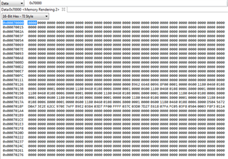

  • Vamsi,
    1) No
    2) Here below.
    TI OTP
    OTP DSCM
    3) I am not able to do that, we have set from external GPIO to Boot from Flash and it used to work properly...
    We are still getting following error :
    And reading from any RAM or Flash area gives us 0s.
    Clément
  • Clement,
    To me it looks as if the device is locked.  Can you check your map file once to see if anything is mapped to the DCSM OTP area? I know you said you did not program any passwords - please check your map file once.
    Once you confirm, I will ask our security expert to take a look at this post.

  • Clement,
    Also, could you download the TI-OTP content from CCS memory window and attach it?
    Thanks and regards,
    Vamsi
  • Hi Vamsi,
    We have checked both our map file and the one from the UART example we uploaded lately and none of them are dealing with DSCM OTP area.
    Find attached the content of the TI OTP in two formats, not sure which one was the more convenient for you so did two.
    1651 9 70000 1 400 7

    0x00070000	0000	0000	0000	0000	0000	0000	0000	0000	0000	0000	0000	0000	0000	0000	0000	0000	0000	0000	0000	0000	0000	0000	0000	0000	0000	0000	0000	0000	0000	0000	0000	0000
    0x00070020	0000	0000	0000	0000	0000	0000	0000	0000	0000	0000	0000	0000	0000	0000	0000	0000	0000	0000	0000	0000	0000	0000	0000	0000	0000	0000	0000	0000	0000	0000	0000	0000
    0x00070040	0000	0000	0000	0000	0000	0000	0000	0000	0000	0000	0000	0000	0000	0000	0000	0000	0000	0000	0000	0000	0000	0000	0000	0000	0000	0000	0000	0000	0000	0000	0000	0000
    0x00070060	0000	0000	0000	0000	0000	0000	0000	0000	0000	0000	0000	0000	0000	0000	0000	0000	0000	0000	0000	0000	0000	0000	0000	0000	0000	0000	0000	0000	0000	0000	0000	0000
    0x00070080	0000	0000	0000	0000	0000	0000	0000	0000	0000	0000	0000	0000	0000	0000	0000	0000	0000	0000	0000	0000	0000	0000	0000	0000	0000	0000	0000	0000	0000	0000	0000	0000
    0x000700A0	0000	0000	0000	0000	0000	0000	0000	0000	0000	0000	0000	0000	0000	0000	0000	0000	0000	0000	0000	0000	0000	0000	0000	0000	0000	0000	0000	0000	0000	0000	0000	0000
    0x000700C0	0000	0000	0000	0000	0000	0000	0000	0000	0000	0000	0000	0000	0000	0000	0000	0000	0000	0000	0000	0000	0000	0000	0000	0000	0000	0000	0000	0000	0000	0000	0000	0000
    0x000700E0	0000	0000	0000	0000	0000	0000	0000	0000	0000	0000	0000	0000	0000	0000	0000	0000	0000	0000	0000	0000	0000	0000	0000	0000	0000	0000	0000	0000	0000	0000	0000	0000
    0x00070100	0000	0000	0000	0000	0000	0000	0000	0000	0000	0000	0000	0000	0000	0000	0000	0000	0000	0000	0000	0000	0000	0000	0000	0000	0000	0000	0000	0000	0000	0000	0000	0000
    0x00070120	0000	0000	0000	0000	0000	0000	0000	0000	0000	0000	0000	0000	0000	0000	0000	0000	0000	0000	0000	0000	0000	0000	0000	0000	0000	0000	0000	0000	0000	0000	0000	0000
    0x00070140	0000	0000	0000	0000	0000	0000	0000	0000	0000	0000	0000	0000	0000	0000	0000	0000	0000	0000	0000	0000	0000	0000	0000	0000	0000	0000	0000	0000	0000	0000	0000	0000
    0x00070160	0000	0000	0000	0000	0000	0000	0000	0000	0000	0000	0000	0000	0000	0000	0000	0000	0000	0000	0000	0000	0000	0000	0000	0000	0000	0000	0000	0000	0000	0000	0000	0000
    0x00070180	0000	0000	0000	0000	0000	0000	0000	0000	0000	0000	0000	0000	0000	0000	0000	0000	0000	0000	0000	0000	0000	0000	0000	0000	0000	0000	0000	0000	0000	0000	0000	0000
    0x000701A0	0000	0000	0000	0000	0000	0000	0000	0000	0000	0000	0000	0000	0000	0000	0000	0000	0000	0000	0000	0000	0000	0000	0000	0000	0000	0000	0000	0000	0000	0000	0000	0000
    0x000701C0	0000	0000	0000	0000	0000	0000	0000	0000	0000	0000	0000	0000	0000	0000	0000	0000	0000	0000	0000	0000	0000	0000	0000	0000	0000	0000	0000	0000	0000	0000	0000	0000
    0x000701E0	0000	0000	0000	0000	0000	0000	0000	0000	0000	0000	0000	0000	0000	0000	0000	0000	0000	0000	0000	0000	0000	0000	0000	0000	0000	0000	0000	0000	0000	0000	0000	0000
    0x00070200	0000	0000	0000	0000	0000	0000	0000	0000	0000	0000	0000	0000	0000	0000	0000	0000	0000	0000	0000	0000	0000	0000	0000	0000	0000	0000	0000	0000	0000	0000	0000	0000
    0x00070220	E599	B962	6648	0096	8000	0001	0000	0600	1180	0460	0108	0006	8000	0001	0000	0600	1180	0460	0108	0006	8000	0001	0000	0600	1180	0460	0108	0006	8000	0001	0000	0600
    0x00070240	1180	0460	0108	0006	8000	0001	0000	0600	1180	0460	0108	0006	8000	0001	0000	0600	1180	0460	0108	0006	8000	0001	0000	0600	1180	0460	0108	0006	8000	0001	0000	0600
    0x00070260	1180	0460	0108	0006	8000	0001	0000	0600	1180	0460	0108	0006	8000	0001	0000	0600	1180	0460	0108	0006	8000	0001	0000	0600	1180	0460	0108	0006	FFFF	FFFF	FFFF	FFFF
    0x00070280	7700	7700	7608	7622	761F	174C	063C	8EA9	1A3C	000F	761F	174D	0602	8BA9	1A03	0007	761F	1746	28A8	0000	28A9	0000	0000	0000	0000	0000	0000	0000	0000	0000	0000	0000
    0x000702A0	0000	0000	0000	0000	0000	0000	0000	0000	0000	0000	0000	0000	0000	0000	0000	0000	0000	0000	0000	0000	0000	0000	0000	0000	0000	0000	0000	0000	0000	0000	0000	0000
    0x000702C0	0000	0000	0000	0000	0000	0000	0000	0000	0000	0000	0000	0000	0000	0000	0000	0000	0000	0000	0000	0000	0000	0000	0000	0000	0000	0000	0000	0000	0000	0000	0000	0000
    0x000702E0	0000	0000	0000	0000	0000	0000	0000	0000	0000	0000	0000	0000	0000	0000	0000	0000	0000	0000	0000	0000	0000	0000	0000	0000	0000	0000	0000	0000	0000	0000	0000	0000
    0x00070300	0000	0000	0000	0000	0000	0000	0000	0000	0000	0000	0000	0000	0000	0000	0000	0000	0000	0000	0000	0000	0000	0000	0000	0000	0000	0000	0000	0000	0000	0000	0000	0000
    0x00070320	0000	0000	0000	0000	0000	0000	0000	0000	0000	0000	0000	0000	0000	0000	0000	0000	0000	0000	0000	0000	0000	0000	0000	0000	0000	0000	0000	0000	0000	0000	0000	0000
    0x00070340	0000	0000	0000	0000	0000	0000	0000	0000	0000	0000	0000	0000	0000	0000	0000	0000	0000	0000	0000	0000	0000	0000	0000	0000	0000	0000	0000	0000	0000	0000	0000	0000
    0x00070360	0000	0000	0000	0000	0000	0000	0000	0000	0000	0000	0000	0000	0000	0000	0000	0000	0000	0000	0000	0000	0000	0000	0000	0000	0000	0000	0000	0000	0000	0000	0000	0000
    0x00070380	0000	0000	0000	0000	0000	0000	0000	0000	0000	0000	0000	0000	0000	0000	0000	0000	0000	0000	0000	0000	0000	0000	0000	0000	0000	0000	0000	0000	0000	0000	0000	0000
    0x000703A0	0000	0000	0000	0000	0000	0000	0000	0000	0000	0000	0000	0000	0000	0000	0000	0000	0000	0000	0000	0000	0000	0000	0000	0000	0000	0000	0000	0000	0000	0000	0000	0000
    0x000703C0	0000	0000	0000	0000	0000	0000	0000	0000	E599	B962	6648	0096	8000	0001	0000	0600	1180	0460	0108	0006	8000	0001	0000	0600	1180	0460	0108	0006	8000	0001	0000	0600
    0x000703E0	1180	0460	0108	0006	8000	0001	0000	0600	1180	0460	0108	0006	8000	0001	0000	0600	0000	0000	0000	0000	0000	0000	0000	0000	0000	0000	0000	0000	0000	0000	0000	0000
    Clément
  • Clément,
    Thank you and we will get back to you after reviewing the TI-OTP content.
    Vamsi
  • Clément,
    This is not a flash programmer issue.  You are not able to load code to RAM as well and RAM is reading back all 0s.
    It can be couple of things:
    1) Device may be power starving.  This might be the case since TI-OTP content is not correct.
    2) Passwords are programmed.  Do you have flash API included in your application to program anything in flash/OTP?  Did any power failure happen during the flash programming earlier?
    Thanks and regards,
    Vamsi
