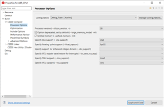

The compiler
The processor config
So the problem began when I chose VCRC in the processor options. Until this time I was not using VCRC and no problem appeared. After adding the necessary libraries and header files for VCRC, when I select the VCRC option in Processor Options, a lot of errors during the linking stage appear:

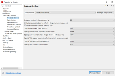

  • I can't share the project for company reasons but I can share you a sample project from TI where it happens the same.
    For the problem of the library F2838xCPU1_CLADATAROM_Symbols_fpu32.lib:
    Pick the project from C:\ti\c2000\C2000Ware_3_04_00_00\libraries\math\CLAmath\c28\examples\asin\ccs
    And configure the project properties following the steps:
    • Set the configuration active to "f2838x_RAM".
    • Compiler to TI v20.2.4
    • Default format was COFF - In F2838x must be EABI
    • In processor options change VCU support to VCRC
    A thing that has surprised me is that in this case changing the VCU Support has changed the error. When VCRC was selected the problem appeared but with other VCU options not. Anyway I would need that library working with VCRC option.

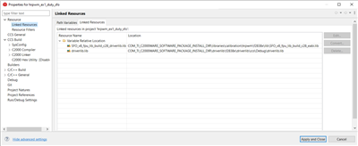

    For the problem of the library SFO_v8_fpu_lib_build_c28_eabi.lib:
    Import the project C:\ti\c2000\C2000Ware_3_04_00_00\driverlib\f2838x\examples\c28x\hrpwm\CCS\hrpwm_ex1_duty_sfo.projectspec
    I have only modified two things:
    • On Properties > CCS Build > C2000 Compiler > Processor Options > Vcu Support -> Set VCRC
    • On Properties > Resource > Linked Resources > Linked Resources (the tab), I set the library that is causing me the failure (SFO_v8_fpu_lib_build_c28_eabi.lib) instead of the driverlib that was originally. Anyway the driverlib library also fails with the VCRC property.
    Please let me know if you need futher information. Thanks again for your support,

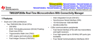

  • For F2838 you need to compile with VCU 2. VCRC is for later devices.
    in terms of features are you looking for anything specific from VCRC ?
  • But the datasheet points out it has VCRC unit, is this info ok?. https://www.ti.com/lit/ds/symlink/tms320f28388d.pdf?ts=1623170459391&ref_url=https%253A%252F%252Fwww.ti.com%252Fproduct%252FTMS320F28388D
    Also the TRM does contain info about the VCRC unit.
  • you are right, i have overlooked on this.
    In that case we need to give F2838xCPU1_CLADATAROM_Symbols_fpu32.lib with CRC option as well.
    I will include this in next c200ware release.
