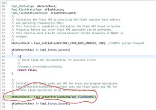

My customer meet an issue which will go into the illegal interrupt after erasing flash.

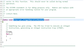

In detail, call  the Fapi function: Fapi_setActiveFlashBank(), the DSP will trigger an abnormal handle --Interrupt_illegalOperationHandler
And they can solve the issue by decreasing the opt speed level.
The CCS compiler version is: 10.0.0.00010, and the optimization level is 3.(This level has issue)
I have customer try disabling ECC-check before calling API functions as this post talked about. But no improvement.
Could you kindly help to give other suggestions?
