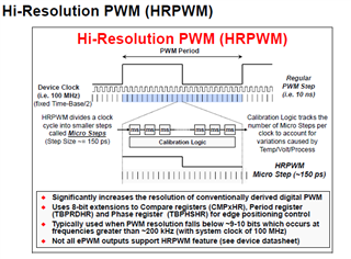

My customer is referring to 7.11.3 Enhanced Pulse Width Modulator in TMS320F004x Datasheet (SPRS945F)
ePWMxA/ePWMxB signals can be controlled with HiResolution steps (150ps min) by HRPWM module as below.

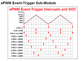

On-chip ADC is triggered by EPWMxSOCA/EPWMxSOCB signals outputted from ET (Event Trigger and Interrupt).
Event-trigger generates an interrupt at event position based on CMPA/CMPB/CMPC/CMPD as below.
Customer question is:
Similar to ePWMxA/ePWMxB signals, Customer wants to control Event Trigger position and EPWMxSOCA/EPWMxSOCB signals with HiResolution steps (150ps min) in order to start ADC with HiReso steps.
Can the ADC start event controlled with HiResolution steps (150ps min) ?
