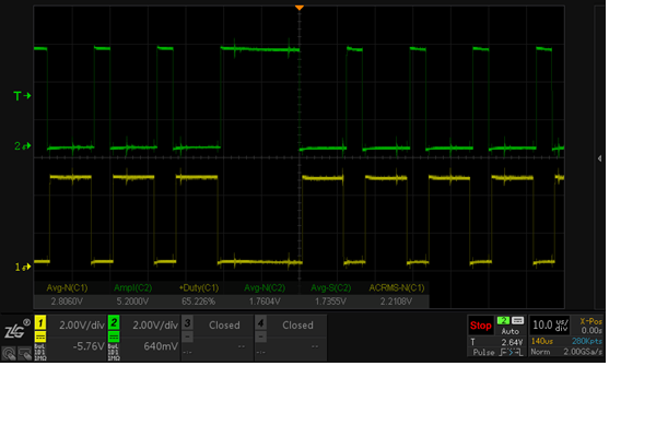

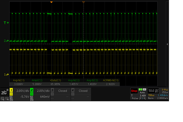

My customer encountered the following problems when using DSP (28377d) as synchronous buck or synchronous boost converter and adopting peak current control (PCMC). Please help to solve them. Thank you!

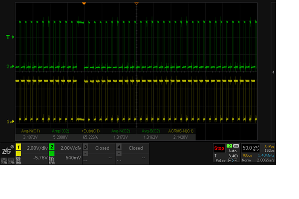

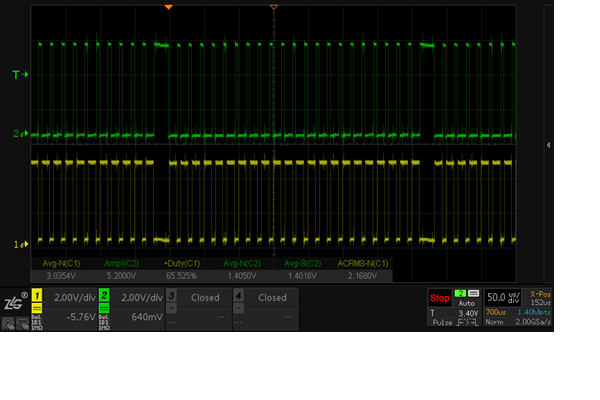

Problem 1: cmps3 is used as the peak current comparison signal, and the external circuit adds a bias value of 1.5V, which is 1.5V when there is no current. By epwm_ Xbar configures the ctriph signal of cmpss3 as trip4, which is input into the DC module of epwm1 to trigger the PWM off signal. See the attachment for the program code.
In the experiment, I observed that a wide pulse will be output from time to time, as shown in Figure 1-3 below. In the oscilloscope, CH2 is the synchronous buck main switch and ch1 is the complementary switch
Figure 1
Figure 2
Figure 3

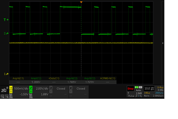

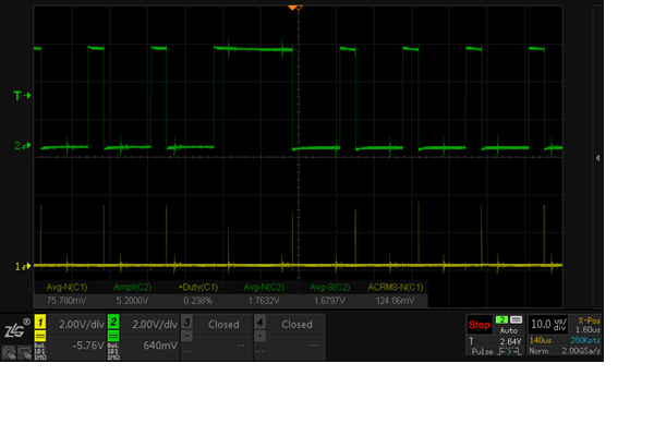

At the same time, my customer also measures the ctripouth signal of cmps3 (output as output3 through configuration), as shown in Figure 5-6. In the oscilloscope, CH2 is the synchronous buck main switch, and ch1 is the ctripouth signal.
Figure 5
Figure 6
My client also measures the cmpin3p signal of cmps3, as shown in ch1 in Figure 7. No interference signal was observed
Figure 7

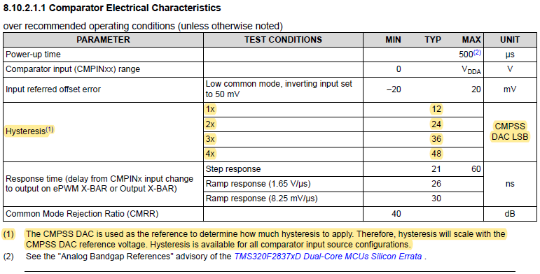

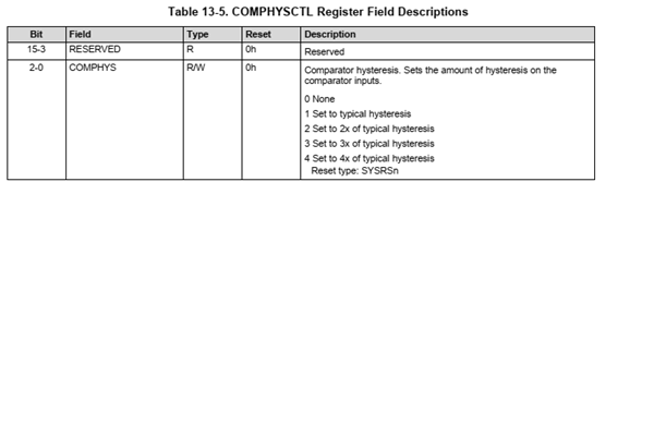

What does typical hypertension mean? Is there any scope?
Is 2x of typical hysteris the above range multiplied by 2?
  • In the experiment, I observed that a wide pulse will be output from time to time, as shown in Figure 1-3 below. In the oscilloscope, CH2 is the synchronous buck main switch and ch1 is the complementary switch

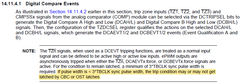

    This sounds similar to the undesired behavior from CMPSS boundary condition issues described in the Errata (search for "CMPSS:") and TRM (search for "CMPSS to Trip").
    Which COMPCTL[CTRIPHSEL] selection is your customer using?  For debug, a good starting point is to use the same selection for CTRIPOUTHSEL.  The ASYNCH selection can be useful for observing the comparator response directly without the effects of the digital logic.
    This is described in the datasheet:

        I see the undesired behavior from CMPSS boundary condition issues described in the Errata (search for "CMPSS:") and TRM (search for "CMPSS to Trip"), this behavior may lost a pulse, but my experiment is different,the PWM should be trip by CMPSS,but it keep high untill next cycle.

  • this behavior may lost a pulse, but my experiment is different,the PWM should be trip by CMPSS,but it keep high untill next cycle.
    This is helpful clarification. The scope pictures are a bit small for full context.
    It may still be a boundary-condition scenario. It looks like a synchronization problem between the comparator and EPWM when it comes to conveying the trip status.
    There is a note in the Digital Compare section of the TRM that calls for the DC input trip signals to be asserted for at least three EPWM TBCLK cycles:
    The code snippet appears to be selecting the ASYNC comparator signal as the EPWM trip source. The ASYNC signal is not guaranteed to satisfy the 3*TBCLK cycle requirement by itself.  The digital filter (COMPHSTS) or latched (COMPHLATCH) signals would be better suited for satisfying the 3*TBCLK cycle requirement.
    It is possible that for some PWM cycles, the Ramp Generator may be qualifying a local trip and resetting the RAMPSTS value to RAMPMAXREF before the ASYNC trip signal satisfies the 3*TBCLK cycle requirement of the EPWM.
    In the scope capture of the comparator input, it looks like a DC test signal is being used to test the CMPSS behavior. For a DC test input, the DACVAL will be held static above the input voltage until the Ramp Generator is released to decrement on the next PWMSYNCPER signal.
    For a real system where the input represents the plant feedback, the comparator would most likely trip the EPWM after some delay when the feedback eventually exceeds RAMPMAXREF for 3*TBCLK cycles.
  • The digital filter (COMPHSTS) or latched (COMPHLATCH) signals would be better suited for satisfying the 3*TBCLK cycle requirement
    I use digital filter (COMPHSTS) signal  to trip the PWM,  the PWM work well.
