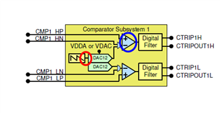

Q5) This question is regarding Note "(2) Includes comparator input referred errors" in 7.10.5.1.2 CMPSS DAC Static Electrical Characteristics.
  Is the "comparator input referred errors" an error happened at RAMP output/DAC12 input - RED circle or an error happen at comparator itself - BLUE circle in below diagram ?

    Q4) That is correct, 25mV is the spec. The figure is just for illustrative purposes, don't read any values from it.
    Q5) The compac output is not directly accessible to a user and it has to go through the comparator and hence any offset errors from the comparator will add to this. This is what the footnote is saying. The 25mV offset error spec for the compdac already includes comparator offset error.
