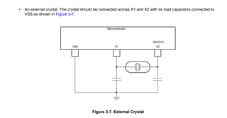

    Any reason why pins 69 (X1) and 68 (X2) are shorted?  Curious as how part is getting clocked.  You mentioned there is an external 20MHz oscillator (not crystal, correct?).  There is a different clock configuration for crystal, which uses both X1 and X2 pins, like in the case of launchpad and an external oscillator, which should only be fed to X1 pin and X2 to be left floating for the part to be clocked properly.  Is the output of the 20MHz oscillator fed to X1 and X2 on your custom board?  You should never short X1 and X2 pins.  Please refer to section 7.9.3.3 (Input Clocks and PLLs) of the datasheet for the different clocking topologies for F280049 device.
    Joseph
  •  This is what i've found in the datasheet. Could you refer to the datasheet you are referencing?

  • Yes, that is likely a cause for CAN module not to function because of incorrect device clocking.
         1.) You need to break the trace between X1 and X2 such that X2 will be left floating and will be following a single-ended clock source (the part you are using 3953M-20-AU is a single-ended clock oscillator, not a crystal) like this topology described in the datasheet:

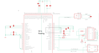

  • Hey Joseph,
    Thank you for leaving the thread open!
    I have followed your instruction documented in the following screenshots, unfortunately with the same result --> the CAN_Tx_Pin (GPIO32) is not showing any change in voltage (before Initialization, it has constant 0V, after Init it changes to constant 3.3V).
    #1                                                                                     #2                                                                     #3
    #4
    full Schematic with X2 floating
    picture of X2 disconnected from X1 now, i will add a foto of the PCB as soon as I've taken a decent one.
    To add for entirety: The other functions are still working on the custom board with changed clock configuration and X2 floating, just CAN functionality on the CAN interface is still not working.

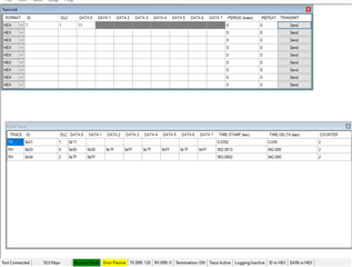

    And here the CAN bus analyzer tool, first working on Launchpad with response, then switching to custom board to receive "Error passive" because no ACK is transmitted from yC, assumingly.
    Again, thank you for your time!
