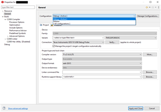

  • Vamsi,
    Which FAQ should I review?
    Properties --> Configuartion
    As you can see in Properties -> Configuration I only have the option to pick either Debug or Release. In the led_ex1_blinky example, you have different options that I do not have on mine.
    Do you know why is that?
    Wilson
  • Wilson,
    This is the FAQ that I shared earlier with you: https://e2e.ti.com/support/microcontrollers/c2000-microcontrollers-group/c2000/f/c2000-microcontrollers-forum/878674/faq-flash---how-to-modify-an-application-from-ram-configuration-to-flash-configuration
    Let me check with our team on why the flash build configurations are not provided.
    Meanwhile, you can go through the blinky example's flash build configuration example.
    Thanks and regards,
    Vamsi
