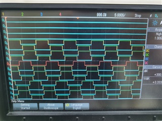

My customer is developing a 3 phase full bridge inverter. He wants to change the frequency of each phase.
The waveform below is what he want to implement.
I have attached source code of PWM configuration.
It consists of EPWM1(Master) / EPWM2~EPMW6(Slave) and set the 3-phase PWM waveform to have a phase of 120 degrees as shown in above pictures
Three-phase consists of PWM1/2, 3/4 and 5/6 pairs.

When slave frequency is changed to be smaller than the master, PWM is not output.
Could I get any advice on this problem?
And could I get some examples related to 3phase full bridge inverter?
  • I am not sure what the exact issue is,
    Main and the Subsidary PWM module should have the same frequency for the phase sync to be usefull. When changing frequency you may need to limit / slew the frequency change to avoid any unexpected timing event occur.
    -Manish
