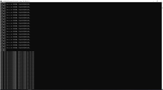

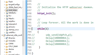

HI,Yashwant Temburu1
After commenting out the udp_send(UdpPcb,p); and delay in the above while, I can ping through with the cmd file.
But as soon as the comment is opened, the ping does not work.As shown below:
The udp_send(UdpPcb,p); and delay in the while will have the same effect on the cmd
ping?
THANKS
VINCE
Check for the transmitted packets in wireshark. The cpu might be continuously transmitting UDP packets.
Check if the receive isr getting called.

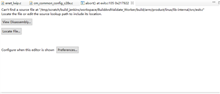

During the debugging process, I encountered a problem, as shown below:
When we burn the CPU1 program into the CPU1 core.
After that, we click to connect to the CM4 core, and the window will pop up as shown below:
At this time, there is no programming routine to CM4 core.
Later, after I burn the program into the CM4 core and run it, the data can be sent out through the UDP protocol and can be received on the host computer.
From the results of the above picture, it has no effect on the overall program. But is it an error that cannot be ignored?
