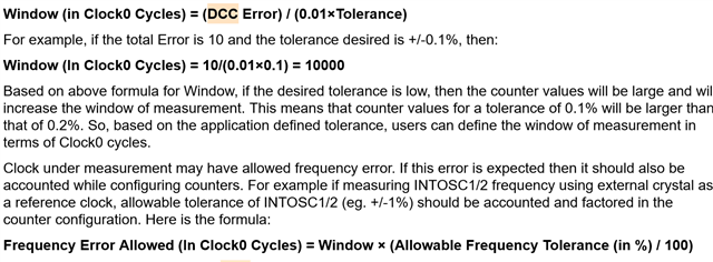

  • Hello Nirav ,
    Here we talked about two tolerances :
    1. Tolerance
    2. Allowable frequency tolerance
    I have this information and would like to ask which tolerance specify the tolerance mentioned in the below picture ?

  • It will be Allowable Frequency tolerance.

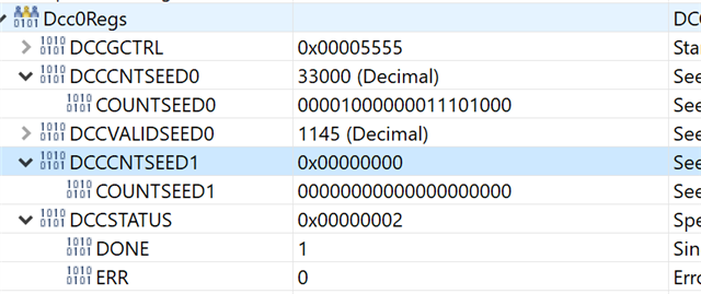

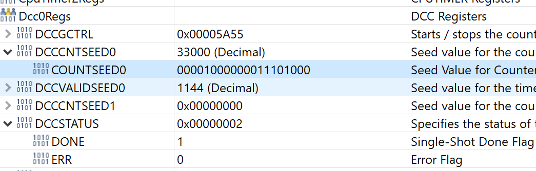

  • Hello Nirav ,
    I meant seed values of the counter , as i am loading the seed values like the following
    DCCCNTSEED0  2880
    DCCCNTSEED1 33000
    DCCVALIDSEED0   240
    So i expect to see the same in the Registers repectively .
    But as you see in the Picture they are either not updated or falsely updated for example
    DCCCNTSEED0 is 33000
    DCCCNTSEED1 is not at all updated and DCCVALIDSEED0 is also false .My Question is why is it so ?
    Code is attached above .

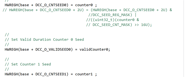

  • Hi Ushma,
    Why are you adding +2 to the offset address inside the code "HWREGH(base + DCC_O_CNTSEED0 + 2U) "? Why dont you assign counter0seed and counter1seed value directly as you do with validcounter0 value " HWREGH(base + DCC_O_VALIDSEED0) = validCounter0;"
    Also, are you using C2000Ware driverlib function? If not, I would highly recommend using that.
    Nirav
  • Hello Nirav,
    firstly, I tried the way you mentioned no Change in the result:
    So, I am following excatly the Code from the C200Ware/ driverlib /f28002x/driverlib/ dcc.c from there DCC_continuousMonitor fucntion  , if this what you are saying to use then yes i am already doing that .
    ALso i tried with this way using structure instead of using HWREGH :
     DccRegs->DCCCNTSEED0.bit.COUNTSEED0 = counter0; // Loaded Counter0 Value
           DccRegs->DCCVALIDSEED0.bit.VALIDSEED = validCounter0;  // Loaded Valid Value
            DccRegs->DCCCNTSEED1.bit.COUNTSEED1 = counter1;
    but same Problem. Could you guide me further ?

  • Hi Ushma,
    That is strange, can you send me your code file? Your code-snippet looks fine, how does the counter0 value get assigned? Also can you also send structure of DCCREGS defined in your code. Some reason it looks like the offset is not mapped correctly.
    Nirav
