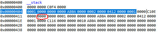

In the following image, you see the stack after the initialisation of the request variable. The blue marked is the request variable. The red circeled the address where the data of request.buffer are saved (0x0000).
After i call the methode, createUInt16Stack(), this new created variable is one address behind (red font 0xFDE8) the last data of the request. So everything is fine.
UInt32 case:
In the following image, you see the stack after the initialisation of the request variable. The colors here mean the same thing.
After i call the methode, createUInt32Stack(), this new created variable is at the same address as the last data of the request and one behind. What happens: the new variables value is now part of my request values (0x8488), because it writes at the same address.

    I am sorry, I had some trouble understanding the memory view. Please correct me if I got it wrong. The data in blue is the entire request variable and one you have circled is a different variable which is not part of Request struct. Is this variable (the one circled) in scope? Note that if you create a local variable in a function, it get allocated to stack, but once that function is returned, that will gone. That means, that address is available for new local variables.

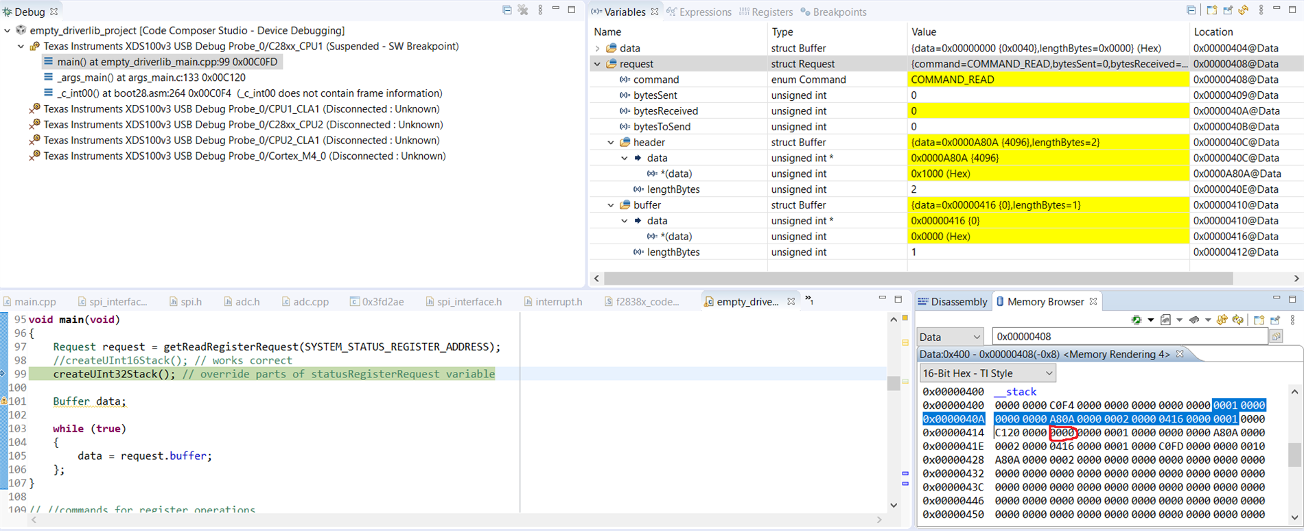

    It would be good if you could share the Variables view in CCS.

    The variable i circled is the address, on which the data of the buffer are created.That means i have in my request a buffer and in that buffer is a pointer to the data. In my request, at address 0x00000040C, is my address to the data (0412). That is the position in stack i circeled.
    Yes of course, i give you the variables view, right away
  • The moment request is initialised. All values how them should be.
    After the new variable on stack.

    So my question is where is the variable at 0x416 allocated? I do not see that in the main. Was it allocated inside getReadRegisterRequest as a local variable?
    If you declare a local variable inside a function, that allocation would be cleared once the function returns.
    Lets say, the SP (Stack Pointer) was at 0x1000 when you call Function1. Function1 allocates some local variables and SP gets incremented to 0x1010. Once the Function1 returns, the SP is reset back to 0x1000. The address 0x1000-0x1010 will now be open for allocating new local variables. When you call Function2, local variable in it will get allocated to the address 0x1000 onwards.
    It is highly recommended not to have function return the address of local variables. The scope of the local variables is within that function.
    Veena
