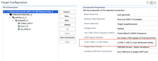

    Can you check the target configuration and make sure they are using cJTAG 2-pin advance mode?
  • Hi Santosh,
    Good Day. Please see below the response of our customer to your reply. Thank you very much.
    Yes, cJTAG 2-pin. Again, the problem is not connecting anymore. The issue is that it keeps dying as an unknown device to windows. That happens independently from CCS and its configurations. That's why I said... or the usb interface from the board is broken (bad ic for example), or the firmware isn't well developed or there is an incompatibility among my usb hub and the usb interface from the board.
