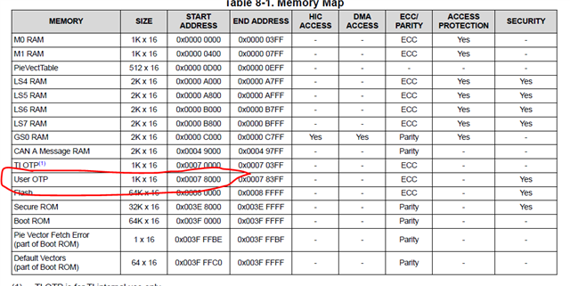

  • Vamsi
    TI's document make me very confused. Please find below image
    Please explain that what is meaning of USER OTP. It is very confused. Furthermore, you suggest to use Flash to store CRC golden sample. I have question about it. Does it affect the CRC value if I put it in my firmware use #pragam CODE_SECTION detective. For example, CRC golden sample of my firmware is 0x0023F30A from CCS (still waiting a reply from TI, how to get it from CCS) and then I put the value to my firmware with below code

  • HK Woo,
    Sorry about that.  I agree that it is confusing (one may understand that it is dedicated to DCSM only if they read TRM). I will forward your feedback to our datasheet team to modify it as DCSM User OTP.
    Regarding your query on CRC value changing by placing it in flash space: You sounded there is already an active post on it- You can continue to discuss there.  If that is not the case, I can assign this to our compiler team to help you further.

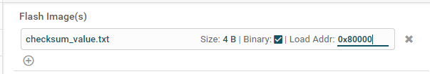

  • Hi HK,
    Regarding the address ranges you mentioned: I believe there are more typos again. But that's ok as long as the address ranges are from flash.
    Regarding the output format:  Maybe you can try the --binary option provided for the hex2000.  Hex format will have header and other info.  Binary might be better for you.  Please try that.  Note that the binary output will not fill the holes with 0xFFFF and instead combines multiple sections.  For your checksum, since you don't need the address, it should be fine for you.
    Regarding production vs runtime: Since it is only production time thing, you can separate the main image as I suggested previously.

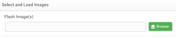

    In Uniflash, you can load a binary file by giving the address in the GUI.  See below.
    Click on the browse button below.

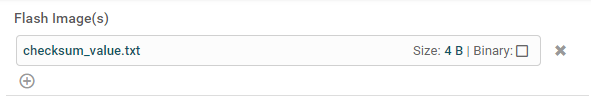

    Select a binary file which you can view/edit in a hex editor.  Below checksum_value.txt is an example binary file in which I have a chosen value.  Select your own file and select the Binary option shown below.
    Once you select, it will let you enter an address as shown below.  You can enter the address (in this example, I entered the flash address 0x80000) and proceed to load image.  Note that the address should be 128-bit aligned.
    Other thing to note for your scenario:  Use "Program Only" option when loading your checksum. This is to avoid erasing the previously programmed application image.
    If you want to use CLI instead of GUI, you can use command like below:

    #2. Please see below.  I used Notepad++ to edit (I used hex plugin).

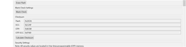

  • Hi HK,
    2) CCS reads entire flash including holes (erased locations) for checksum calculation. For your custom function, did you consider this?

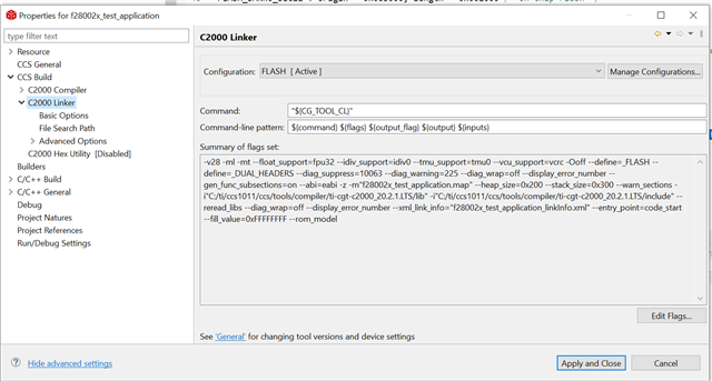

  • Vamsi
    I tried your suggestions in 2 tests.
    Testing 1. -.Add flag --fill_value= 0xFFFFFFFF in C2000 Linker in CCS as below
                            -. Using  .out  to generate a file in array format with hex2000 -a -romwidth=16 f28000x_test_application.out
                            -. View the content of converted file 1.a00
    Result         : hole is not filled with 0xFFFFFFFF
    Testing 2.  -. Keep the flag --fill=0xFFFFFFFF
                        - Change content of link file " .text            : >> FLASH_BANK0_SEC2 | FLASH_BANK0_SEC3 | FLASH_BANK0_SEC4, ALIGN(8), fill=0xFFFF".
    Please let me that do I do a correct procedures or not.
    I tried to attached f28000x_test_application.a00 and .out for your reference but not successful. Or you can share converted array format file while holes are filled with 0xFFFFFFFF

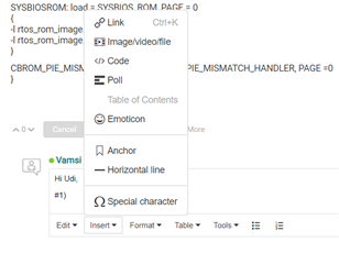

    Regarding file upload: Click on insert button at the bottom of your reply pane.  Then click on Image/Video/file and upload your linker cmd file (rename extension as .txt).
