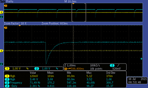

My customer implements one EtherCAT firmware upgrade function, means that F28388D receives software image via EtherCAT and then do flash programming. But after he finish CPU1 upgrade, F28388D fails to boot up and outputs a low signal to XRS pin periodically, please refer to below pictures.
This waveform looks like watchdog reset is happening, but the strange thing is that we don't see 512 OSCCLK(51.2us) low period. My customer cannot connect F28388D via JTAG port with correct password,  then he sets SCI Boot(GPIO72 = 0, GPIO84 = 1), power cycle his system and get same result, F28388D outputs a low signal to XRS pin periodically.
    How long it's low in the waveform ? It's not clear from the attached snapshot ? If it's not WD reset then could it be due to bad power supply or some external voltage monitor ? Can you request customer to scope that and check.

  • Vivek,
    The low period is about 51 us, so this should be the watchdog reset.
    I had a further discussion with my customer, found that there was a logic bug of his software. He executed Fapi_issueProgrammingCommand() and then didn't do while(Fapi_checkFsmForReady() == Fapi_Status_FsmBusy);. This means that the software may do Fapi_issueProgrammingCommand() again when Flash controller is still busy, this is the root cause he fails to program flash memory.
    This problem is fixed when my customer executes while(Fapi_checkFsmForReady() == Fapi_Status_FsmBusy) after Fapi_issueProgrammingCommand() function, he can program flash and DSP boot up from flash without problems now.
