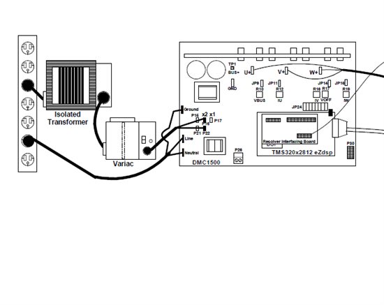

To run the motor, we need a DSP board like EZdsp2812. AC 220V input and do we need extra power supply 24V or others for the gate drivers?
if so, any recommendation for the power supply?

Please check the documentation of PMSM3_3 system documentation for a good idea on DMC1500 connection. Basically you will supply AC voltage to power only the control circuitry without energizing the DC bus. You should supply DC bus using a variac so that you can develop system code without needing to apply full DC bus voltage. Please make sure all jumpers/settings are appropriate for 220V AC input.
Please see below for a diagram taken from PMSM3_3 system documentation.

Now I am connecting BLDC motor, DMC1500 and Ezdsp2812 setups based on TI documentation, no motor is running with BLDC_3_1 program from TI website.
I checkthe PWM signals, just 1sec on pulse trains and 3 sec off zero pulse with less 10 V from DMC1500 and even only Ezdsp2812 same like this 1sec on pulse trains and 3 sec off zero pulses, how can I fix those problems, all connections are based on TI documentation.
