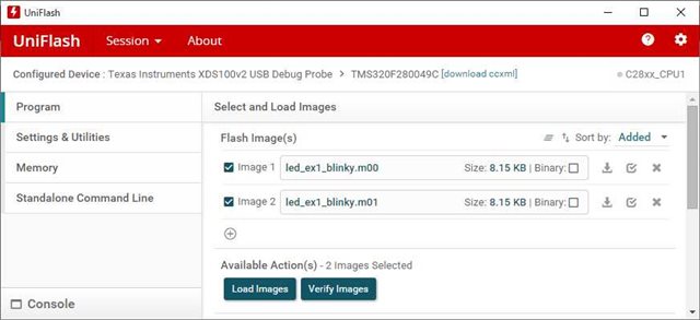

    HEX2000 -m aaaa.out generates aaaa.m00 and aaaa.m01. Is it possible to program them to F28004x through XDS200?
    I have tried with UniFlash with XDS100v2, however it shows error as follows:
    Thank you for your check.
    Hitoshi
    Please use the *.hex file generated when hex generation is enabled in CCS. Note that you can also program the *.out file too.
    Thank you
