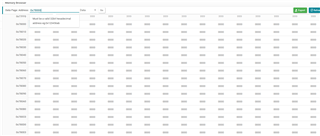

Im working on flash programming on TMS320F280025C launchpad and out of the blue I started getting the following error;
C28xx_CPU1: GEL Output: ... DCSM Initialization Done ...
C28xx_CPU1: Warning: Failed unlocking device (zone 1) after reset.
C28xx_CPU1: Warning: Failed unlocking device (zone 2) after reset.
C28xx_CPU1: Flash Programmer: Error erasing Sector 0. FMSTAT value = 1040. Operation Cancelled (0).
C28xx_CPU1: File Loader: Memory write failed: Unknown error
C28xx_CPU1: GEL: File: C:\Users\hdsouza\workspace_v10\Bootloader_f28002x\CPU1_FLASH\Bootloader_f28002x.out: Load failed.
I would like to know how to solve this issue.
Is the device locked? If yes how to identify what caused this so that I dont brick other devices.
Im attaching my .map file as well as the screen shot of the memory section

    Firstly, my apologies for the late response.
    Based on the attached screenshot of the memory window, it certainly seems that the DCSM OTP has been incorrectly programmed.
    To confirm this, please attach the screenshot of DCSM memory map section (0x5F000 - 0x5F07F).
    Also, one other reason that I have seen where such data is seen in the DCSM OTP sections would be to ensure there are no Power glithes during Flash operations.
    Hope this helps.

  • Hi Pramod,
    Thanks for the reply attaching the screen shot of the DCSM memory map section
    So is this controller bricked? Is there any way of recovering it?
    As you mentioned that Power fluctuations during flash operation is one of the reason for this, can you let me know what other reason can there be for the OTP to have such data. I just want to know all possible reasons so its can be taken care of.
    Harsha Jason Dsouza
  • Hi Harsha,
    Yes. This particular device is now permanently locked based on your latest screenshot.
    One other reason that I am aware of which would lead to all OTP locations being programmed to 0 would be incorrect use of Linker command file. You need to always take extra care if you have OTP locations to be programmed a part of your project. Although I don't see this being a cause for your issue. (I am saying this because as per your map file screenshot, I see the DCSM OTP region as an unused section).
    Hope this helps.
