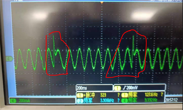

During the start-up process, the motor will shake.This seems to be caused during the process from "ENC_ALIGNMENT" to "ENC_WAIT_FOR_INDEX"
As shown in the figure, when the current has a sudden change, the motor will vibrate.

  • Was LEVEL3 testing ok?  IF you saw the same problem, then you may have to swap two wires to the motor.
    If LEVEL3 is ok, then the problem may be high values of speed loop PI gains. You may reduce that. Also, you may want to reduce teh start up IqRef value. Pls review the code in LEVEL4 at the starting sequence to figure this out.

  • If the sense of rotation of ABC sequence in the motor and that of the encoder feedback are opposite, then the motor will stall. That is the reason for swap. If the original sequence was ok in BUILD3, then that sequence is correct.
    If you get good LEVEL3 performance in starting, then in LEVEL4, set the starting IqRef value to be around what you used in LEVEL3 and go from there.

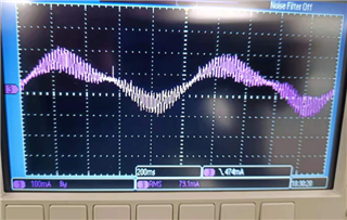

    But currently I have encountered a new problem,Under the same speed loop KP and Ki, the forward rotation and reverse rotation of the motor behave differently.
    Forward current waveform:
    Reverse current waveform:
    I think this is wrong. There should be no difference between forward rotation and reverse rotation. Do you have any comments on this?

  • I would suspect the deviation of angle feedback zero degree with actual zero degree of phase A that is the basis angle for FOC. Try to tweak this value and see if it helps.
  • Hi Ramesh,
    Do you mean you want me to modify IdRef_start or alignCnt to get a more accurate initial positioning of the motor?
    Thanks.
    Jenson
  • You could try that. Or, within the debug window, play around with the value of calibratedAngle. Try tweaking values basically to see where the potential fix could be.
    If it does not get better, I would think that the non linearities (or errors) in feedback sensing of phase current could be the reason. The control is based on angle and currents. If angle is not contributing to error, then it can be the currents only. See if the phase current sensing is alright.
    First, you may run the motor in open loop in both directions and confirm if direction is not an issue reg current wave shape.

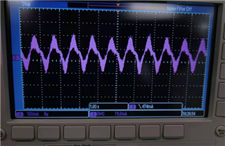

    1. The iq_fbk of the motor can follow iq_ref. When I set iq_ref to 0.01, iq_fbk can follow iq_ref very well. But there will be abrupt changes in the current waveform. And the torque of the motor is very small. When I load the motor, the motor stops.
    2. When I set iq to 0.1, iq_fbk can follow iq_ref, but the following fluctuations will be large, and the current of the motor is also very strange. It seems that there is a problem with the PI parameter setting of the current loop.
    It seems that there is something wrong with the adjustment of the current loop. Do you have any comments on this?
    Jenson
  • The abrupt spike is something to do with feedback sensing. It could be noise pick up in sensed current value or it could be in position feedback. From the location of spikes in the current waveform, it appears that this problem could be sourced from position feedback. Consider checking the position feedback.
    Secondly, if level 3, the motor operates in constant current (constant torque) mode. In this mode, if you apply a load greater than what you are commanding, then the motor will stop, which is natural.

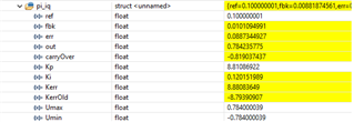

    1.What I check is the current pid parameter setting of the current loop (iq) as shown below. Is there any theoretical basis for this setting? Are there any reference settings? Secondly, how to roughly debug the setting of the speed loop?
    2.What is the relationship between Iq_out and Iq_fbk and the current value? For example, if I set Iq=0.5 in Level, what is the corresponding output current of the motor? Is he related to M1_BASE_CURRENT? What is their relationship. (Currently, customers use level3 and want to know what is the output current corresponding to the input iq)

  • Jenson,
    I think this thread is now going all around with many issues. Can you close the thread and start a new thread for a different query from now on? I can answer this particular query here though.
    1.refer to this link
    (+) Teaching Your PI Controller to Behave (Part I) - Industrial - Technical articles - TI E2E support forums
    2. Per unit scale normalizes the variable on a scale of 1.0, and the base value is the max value the hardware sensing circuit can sense.
    3. Pls read the user guide for what this function does.
