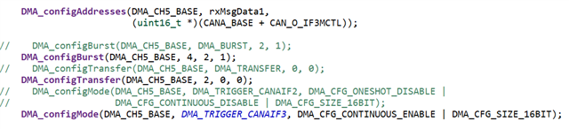

   I am using IF3 registers with DMA mode.  My program configuration is as follow(based on "can_ex4_loopback_dma"):
1.  The DMA src Addr is CAN_IF3MCTL, and I want to move 2 words with DMA. It will move the value of CAN_IF3MCTL and CAN_IF3DATA register to  the Custom array "rxMsgData1[4]" ideally.
2. For testing, I only set Data_B bit in CAN_IF3OBS Register.
3.The result is as follow:
   CAN_IF3MCTL and CAN_IF3DATA register get the true value, and the Custom array "rxMsgData1[4]" also get the true value by DMA.
QUESTION:
1.But what surprised me was that I only set Data_B bit in CAN_IF3OBS Register. I didn't set Data_A bit or Ctrl bit in CAN_IF3OBS Register at all. Why?
2.IF I want to use IF3 registers with DMA mode, how can I  configure the CAN_IF3OBS Register and related registers of DMA?
  • In addition, I am using F28379 also, there are not DMA mode. But I found that  Data_B/Data_A/Ctrl/Arb/Mask bit of CAN_IF3OBS Register have no effect.
    I don't need to configure one of "Data_B/Data_A/Ctrl/Arb/Mask" bit when automatic IF3 update. I only configure appropriate value in CAN_IF3UPD register.It will move the message from mailbox to IF3. And I can read IF3 register by CPU(not DMA). The same as F280049C

       1).IF I want to use IF3 registers with DMA mode, I have set DE3 bit in CAN_CTL register and IF3UPD is set to the proper mailbox. But, I arbitrarily set one of "Data_B/Data_A/Ctrl/Arb/Mask" bit in CAN_IF3OBS Register,it will cause DMA transfer. I originally thought that if  I want to configure
    "DMA_configAddresses(DMA_CH5_BASE, rxMsgData,  (uint16_t *)(CANA_BASE + CAN_O_IF3MCTL));".
    I must set Ctrl bit in CAN_IF3OBS Register, but it's not. If I set anyother bit, it will trigger the DMA transfer. So, I don't know why?

    I have configured:
    DMA_configBurst(DMA_CH5_BASE, 4, 2, 1);
    DMA_configTransfer(DMA_CH5_BASE, 2, 0, 0);
    DMA_configMode(DMA_CH5_BASE, DMA_TRIGGER_CANAIF3, DMA_CFG_CONTINUOUS_ENABLE | DMA_CFG_SIZE_16BIT);
    DMA_setInterruptMode(DMA_CH5_BASE, DMA_INT_AT_BEGINNING);
    HWREG(CANA_BASE + CAN_O_IF3UPD) =  0x00000002;
    HWREGH(CANA_BASE + CAN_O_IF3OBS) =    CAN_IF3OBS_DATA_B;
       My purpose is:
      CAN module automatic IF3 update, and enable DMA mode.  Then, two words(CAN_IF3MCTL and CAN_IF3DATA)  will be moved from IF3 to C28x memory.

  • Lei,
    Ok, I think I understand your point.  What you are doing is configuring DMA and pointing to IF3MCTL as IF register for the transfer transaction.  You configured IF3OBS and regardless which bit you set (DATA_A or DATA_B or ARB or MASK or CTRL), you get the correct value of IF3MCTL in C28 memory.  Let me dig deeper into this and how to properly use IF3OBS in DMA mode.
    Joseph
  • Lei,
    I just realized this note in the description of CAN_IF3OBS:
    "Note: If IF3 Update Enable is used and no Observation flag is set, the corresponding message objects will be
    copied to IF3 without activating the DMA request line and without waiting for DMA read accesses."
    As long as you have updated IF3UPD with the message number, transfer will proceed even if IF3OBS bits[4:0] are not set.  You can also try an experiment where you do not set any bit in IF3UPD but set the IF3OBS bit 2 (or any other bits) and see if you get the DMA transfer to proceed.

  • Hi Lei,
    Yes, just got inputs from design and they have clarified the behavior of IF3OBS.
        - The main purpose of IF3OBS register is to control the NEXT IF3 update, meaning the action from the IF3OBS setting will only take effect on the next received frame.
        Here are two examples to illustrate this:
        Example 1:
                - IF3OBS set to '2' (IF3ARB register has to be read for next IF3 update)
                - IF3UPD = '1' for mailbox 1
                - Receives first transaction and C28x RAM and IF3 are both updated
                - DMA is triggered and DMA is configured to read IF3ARB register
                - When next frame is received, both C28x RAM and IF3 registers are updated with fresh data.  IF3 DMA line is also triggered.
        Example 2:
                - IF3OBS set to 1 (IF3MSK register has to be read for next IF3 update)
                - When next frame is received, C28x RAM is updated with fresh data but IF3 registers are not updated because DMA has not read the IF3MSK register which was set in IF3OBS.  In this example IF3OBS register setting is blocking IF3 update because IF3MSK read did not happen.
    Hope the above examples illustrate the function of IF3OBS register.
