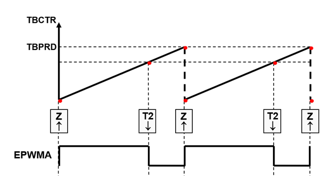

I have a customer which is developing a Buck using peak current mode control.
and they use a DC input as the analog sample, to compare with internal RAMP.
however, when they increase ramp max value. and they hope the duty is near 100%, they will meet lost PWM waveform.
just as below picture
input 1 is normal, input 2 is lost PWM.
the code is attached.
it seems the comparator works, but after that the PWM is not return to high voltage for some period.

could you kindly point out the possible wrong setting?
BR
Emma
