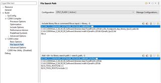

The compilation process throws a lots of errors as below:
The linker settings for the projects are shown below:
The linker command file is shown below to check if the FFT sections are properly allocated.

Please note that I have started working with the TI controllers only one month ago and I am not well versed with linked command file so kindly verify if all sections are allocated correctly. I will highly appreciate if these allocations can be revised  for better processing time and more efficient memory usage. Meanwhile I am looking into the "Fixed Point DSP Software Library" document from the C2000Ware directory to troubleshoot at my end. I have taken reference from "FixedPoint_RFFT" project written for f2838x controllers.
  • Asad,
    After a lot of debugging, I noticed the lack of '{' at line 207. Can you add that and see if it persists?
