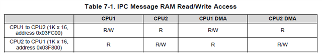

    In cpu01_to_cpu02_ipcdrivers_cpu01.c, the MSG RAM used is CPU02TOCPU01_PASSMSG  0x0003FBF4.
    As per the manual, CPU2 has R/W access and CPU1 has only R access to this RAM
    But the example implements IPCLtoRDataWrite and IPCLtoRBlockWrite to this RAM (i.e. CPU01 is writing to 0x0003FBF4).
    Could you please explain this?
  • Hi Rashmitha,
    Please look into the implementation of the driver functionIPCLtoRDataWrite. Actually, it send the address and value. Then actual write is done by CPU2.

  • Hi Santosh
    I looked into the code and doc too.
    The user guide says "This function will allow the local CPU system to write a block of data to the remote CPU system starting from the location specified by the ulAddress parameter. Prior to calling this function, the local CPU system code should place the data to write in shared memory starting at /e ulShareAddress."
    Here Local is CPU1 and Remote is CPU2, and ulAddress being passed is pulMsgRam which is 0x0003FBF4. ulShareAddress is Global shared RAM address.
    So in cpu01_to_cpu02_ipcdrivers, as per the guide if IPCLtoRDataWrite is called it should be CPU1 doing the write to the shared memory, isn't it?
  • Rashmitha,
    If you have a board (F28379D controlCARD or Launchpad), I will suggest you to build the code and run the codes on target.
    On CPU1, it populated a structure, which has address and value, then send ipc command. On CPU2, it wakes IPC ISR, then it reads the address and writes the value. So actual write happens on CPU2
