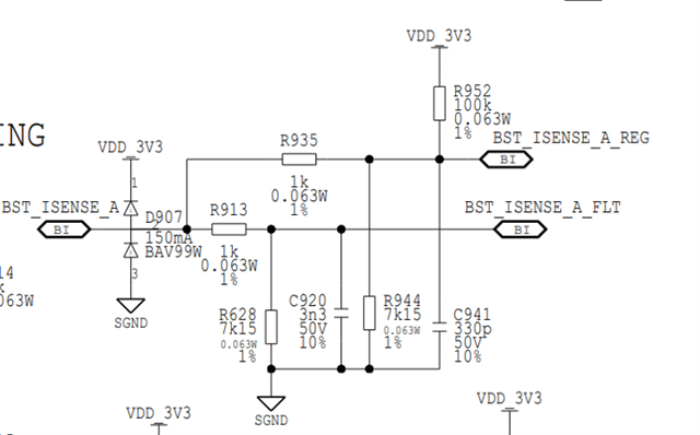

  • Hi Cody,
    Thanks for your reply. another questions, did we need to remove the external clamp diode since we have an internal clamp diode? if we add an external clamp diode, what side effect will bring?
    BR
    Emma
  • It is OK to have an external clamping diode. Please note that the internal clamping diode will have a relatively low current limit.
    If you have an external clamping diode it is important to know where the current is flowing. If you put an external diode in parallel with the internal diode the current will be shared. And due to process either the internal or the external diode may take more of the current, it depends on the exact voltage threshold of each diode.
    A resistor or low pass filter placed between the diodes can help bias the current flow towards the external diode.
    Cody

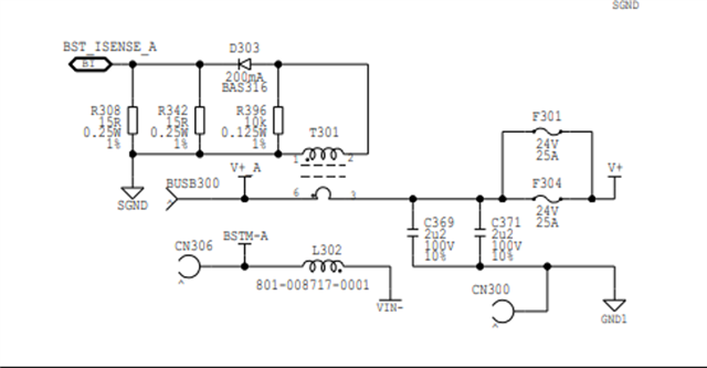

  • Cody,
    Thanks and got it.
    However, customer use CT to sense the current and the minus voltage may happen.
    Below is their schematic.
    I just want to know. whether we have a recommend on how to add diode in this scenario (minus voltage may happen).
    since customer told me there is only very small minus voltage, then the device broken. it happens so many times in their test.
    BR
    Emma
  • Emma, yes you should apply some sort of clamping diode to keep the voltage from going below VSSA.
    You can see something similar mentioned here. https://e2e.ti.com/members/1120590
    Cody
