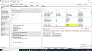

We are using a custom board with Instaspin for F28004xC. For some gains, the motor spins up (unloaded) however the power draw is much higher than expected and the speed feedback shows a large negative number when the setpoint is positive. Is there any documentation on what can cause this? Our board is using 3 low-side shunt resistors for current sensing, and we are using the smart gate driver DRV8353 which has the integrated current sensing gain stage.
See image before for snip from the debugger, showing negative speed:

  • Hi Yanming,
    We are running lab 2 as you suggested. The current sensing is looking correct however, when we perform the voltage offset calculation, the output from the lab is ~0.5 for each phase voltage, compared to the lab example which specifies 1.
    We are operating with a DC bus of 15V, and at 50% voltage measure ~7.5V so a 0.5V offset makes sense, but it is unclear why in the lab for a similar 50% duty-cycle their offset is close to ~1.
    Here is a snip of our outputs before and after the offset calc is performed
  • Hi Yanming in addition to above, we decided to proceed with Lab3 and Lab5 with the following results:
    We progressed through lab3, however when we went to Lab 05 we are seeing an initial current spike that browns out our supply (> 25A). We tried reducing the USER_MOTOR_RES_EST_CURRENT_A and USER_MOTOR_RES_IND_CURRENT_A from 3 and -3 to 0.3 and -0.3 but that had no effect. We saw a similar issue with lab 3, however we resolved this by reducing USER_MOTOR_VOLT_MIN_V and USER_MOTOR_VOLT_MAX_V from 4 and 24 to 0.3 and 2 respectively. Could this be a clue as to what is going on with Lab 5?

  • Hi thanks for the help, we discovered our issue was we mapped the EPWM#A to the low-side FET and EPWM#B to the high-side FET, once this was swapped we got expected results
