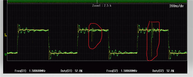

Hi experts,

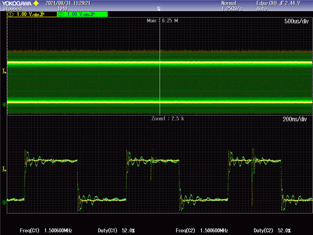

My customer use the manual convert mode. The wave seems strange as below:

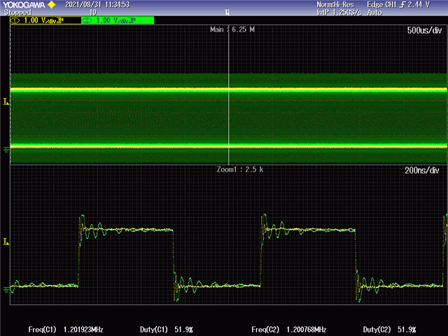

If they change to auto-convert mode. The wave is right:
Please help review the codes. Thank you in advance!
