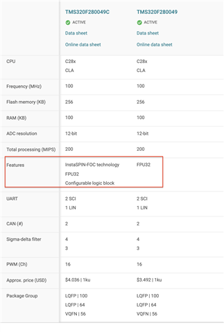

Could anyone please tell me the difference between F280049PMS and F280049CPMS DSP? I checked through the datasheet and could not see the difference.
But if they are the same, why would TI use two different part numbers for them? Thanks!

F280049CPMS has Configurable Logic Block (CLB). In the data sheet, you can refer to device comparison table. 4-tiles of CLB is available in device in F280049C
