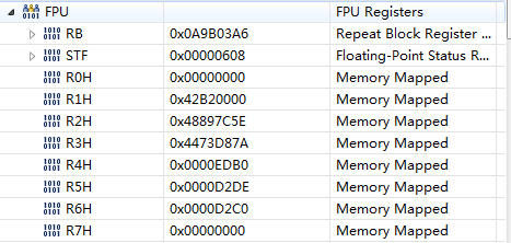

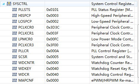

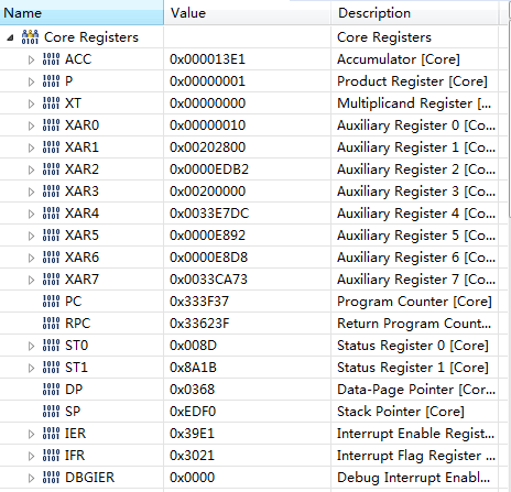

  • Dear tomy&Stehpen,
    customer used nested interrupts;please refer to below rigister value when system enter LLEGAL_ISR(void);
    i will loop customer in the forum posts;
  • Cickey,
    It does look like an Illegal Instruction trap. Do you know if the CSM is used to secure memory on the device?
