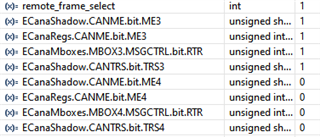

    However, I found issue when using 1xLaunchXLf28069m and 2xLaunchXLf28379D. From three 120-ohm resistors on the bus, one is removed (desoldered), hence two 120-ohm resistors terminate the ends. The f28069m acts as master which is able to transmit two different remote frame on the bus (but only one at a time, using selector scheme) which is then received by two DCAN devices each has unique Message Object ID. The remote frame has been transmitted successfully, the reply message has also been received in the master (eCAN) mailbox. The issue is that once the remote frame is transmitted by master, only the Message Object ID with the lower value (hence higher priority) is able to respond. How to get the lower priority Message Object also be able to respond to the remote frame? Which DCAN register require attention to solve this issue? Please kindly advise. Thank you!
  • Sorry, your question is not clear. Please provide the MSGID of all the mailboxes involved in each one of the 3 nodes. Then, clearly indicate the sequence of transmission.

    The sequence of transmission is indicated by the code below.
    //The selector scheme:
    if(remote_frame_select == 1)
    EALLOW;
    ECanaShadow.CANME.all = ECanaRegs.CANME.all;
    ECanaShadow.CANME.bit.ME3=0; //Disable
    ECanaShadow.CANME.bit.ME4=0; //Disable
    ECanaRegs.CANME.all = ECanaShadow.CANME.all;
    ECanaMboxes.MBOX3.MSGCTRL.bit.RTR = 1;
    ECanaMboxes.MBOX4.MSGCTRL.bit.RTR = 0;
    ECanaShadow.CANME.bit.ME3=1;
    ECanaShadow.CANTRS.all=0;
    ECanaShadow.CANTRS.bit.TRS3=1;
    ECanaRegs.CANTRS.all = ECanaShadow.CANTRS.all;
    if(remote_frame_select == 2)
    EALLOW;
    ECanaMboxes.MBOX3.MSGCTRL.bit.RTR = 0;
    ECanaMboxes.MBOX4.MSGCTRL.bit.RTR = 1;
    ECanaShadow.CANME.bit.ME4=1;
    ECanaShadow.CANTRS.bit.TRS4=1;
    which is run at Node 1 (LaunchXL-F28069M).

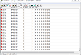

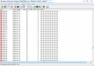

  • Hi Vince,
    Thanks for your support. I found that using a CANTalker device, when sending the remote frame for Node 3, the remote frame for Node 2 is somehow also transmitted. This eventually causes Node 2 to respond since it is assigned with a higher priority MSGID.
    1. Please swap the message IDs of Node 2 and Node 3. Let me know if the issue now moves to Node 2 (since before it was on Node 3).
    I swapped the message IDS of Node 2 and Node 3, and, yes, the issue now moves to Node 2!
    2. Please take a scope capture of the RX pin of the bad node during the full sequence of transmissions from the master.
    Rather than a scope capture, I provided a data window captured by a Can analyzer, which shows that during request of the lower priority MSGID, the request of higher priority MSGID is somehow also carried and transmitted.
    This led to another question, is this more a register programming issue, or does the CAN protocol behave this way?
    Thanks for the follow-up. To answer your final question, the CAN protocol will always allow the highest priority frame through only, all other nodes will stop communicating when they realize they are not the highest priority. Therefore, if we have a situation like this, where the highest priority node is essentially "taking up" all the communication time, the other nodes will not get a chance to communicate/talk.
    So to see if this is from the sending protocol side, could you put a very long delay (maybe 1 second) between each transmission and see if this resolves the issue? I would guess this is the root cause, that basically the transmitting device is conflicting its own transmissions (by sending additional transmissions before the first one has finished sending).
    Vince
