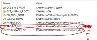

    I have another option, C:\Users\F2806x_examples_ccsv5
    Do you want me to use it?
  • Hasan,
    Is that last path from the import of the project into CCS, or the path where the example director is installed?  The reason I ask is that when you import a project into CCS it creates a local copy in the User/workspace name/ path on your machine.
    I believe it attempts to copy over everything in the target directory, but I think where things get messy is if there are alot of relative paths going on.  Sometimes it is simpler to just add the dependent files in the project directory that is imported for the sake of the path resolution.
    I'm not really sure why CCSv5 would be much different than CCSv10 in this regard.
    The example you mentioned, is this from a TI source, where I could install it in a similar path on my machine?
    Matthew
  • Is that last path from the import of the project into CCS, or the path where the example director is installed?  The reason I ask is that when you import a project into CCS it creates a local copy in the User/workspace name/ path on your machine.
    Dear Sir,
    In this regards what I did is copied my project folder from different cloud storage then make a workspace in Onedrive and pest it. This project only supported by C:\F2806x_common and C:\F2806x_headers. CCS installed here C:\ti\ccsv5
    If I need any files to add in project tree I usually use those location. Dont you think onedrive is a problem? both of them stays in C drive!
    I do believe what you said again. Let me show you, project>properties>Recourses>Link Resources>
    Workspace location went wrong?
  • I'm not sure the effect of the workspace_loc in this regard.  Can you create a new workspace and re-import the project to see if we can get alignment?
    Matt
    Dear Sir,
    Its true that those workspace_loc parameter and path cant be change in the properties.
    Let me make again a workspace.
