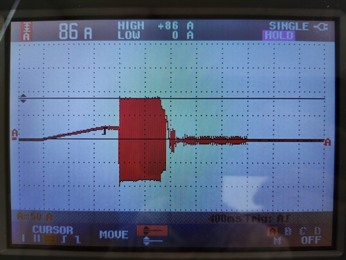

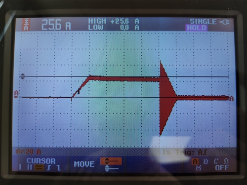

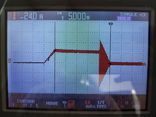

    Sorry for the delay, but customer is busy so they won't be able to send us images by the moment. Anyway, I take some pics of the current waveform in our installations. Here they are:
    RampUp + Fine time
    Fine time
    Current value
    So as you can see after Rs recalculation, in this case the motor spins to the correct speed reference. However, we found that the RampUp time and ResEst current are not appliying correctly. These are the values we used in the pictures above:

    We have seen that changing FineWaitTime works correctly, but changing RampUpWaitTime has no effect. Changing IndEstCurrent has some effects on the maximum current value, but doesn't match with the assigned value.
    We are 100% sure that the problem occur during the encoder alingment process, but we don't see anything wrong. May you provide us some guidance on how to face this problem?
    EDIT

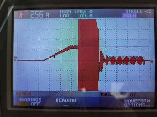

    We got some pics with the problem. All the variables have the same value excepting FineWaitTime, which has the original value (we have checked that this has no effect on system operation).
    As you can see, as soon as the Rs recalculation ends the motor spins at its maximum speed until we take some action. Hope this help.
    BTW, can we somehow check if the alignment process is correctly done? We think that could be very useful to solve this problem.

  • You can try run the motor without load first to see if there is the same issue. And to check if the issue is only appeared at running the motor with heavy load. If yes, that means the rotor is not aligned to the zero position for encoder offset calibration.
    You should set an enough FineWaitTime for implementing the Rs recalculation to make sure that the rotor is forced to zero position.

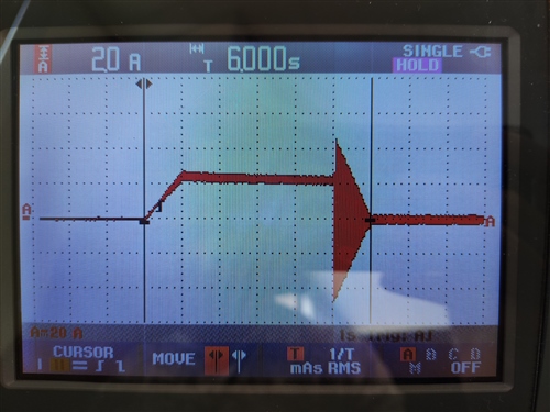

  • Apparently we solve the problem doing 2 alignments in a row. This way, by the moment at least, we are able to confirm that the encoder counts are the correct ones comparing the results of the 2 alignments. Also increased the fine time, at this moment to 3s, we will be experimenting a few days with this value, algo with the 5s you proposed, and then I will update information about the problem, ie if it has been corrected in all situations, if there is any configuration better than another etc.
  • Good. You have to ensure the rotor is forced to zero position for encoder offset calibration every time.

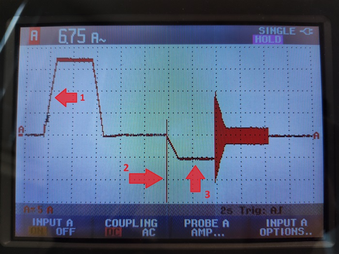

    I have 3 questions related to the Rs recalculation process. I'm attaching a current waveform obtained with the current test parameters.
    1. Why Rs RampUp time is still not in concordance with the value we set in user.c? Other times are applying correctly.
    2. Have you some idea why this spike occurs? It happens often, sometimes it is almost unnoticeable, but generally is as huge as this pic shows.
    3. The current level on the second Rs recalculation is extremely small compared to the first one (USER_MOTOR_RES_EST_CURRENT is set to 10A, so first recal is applying more than assigned, and the second less than assigned).
  • Why Rs RampUp time is still not in concordance with the value we set in user.c? Other times are applying correctly.
    It also depends on the current ramp rate, you might ignore this, and just make sure that the fine time is correct that is import to force the rotor to the zero position.
    It seems like the reference torque current is too large. You might reset or configure the integral variable of both speed and current PI to a appropriate value.
    Phase 2 and 3 are not for Rs recalculation. Do you enable force angle?

    We finally solved the problems discussed last day except RampUp time, but as you recommended, we will focus on Fine time. More experimenting need to be done in order to afirm 100% sure that the problem has been solved, but apparently it is so.
    Thanks for your support and time, you can close this thread.
