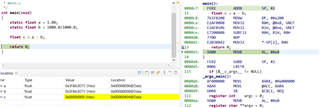

In my code,
static float foo=1.08;   // hex value in memory for foo is 3F8A3D71, the actual float value = 1.08000004
foo = 1080.0 / 1000.0;   // hex value in memory for foo becomes 3F8A3D70, the actual float value = 1.07999992
Since we calculate checksum based on hex content, checksum would return a different value even when the actual foo value for our purpose has not changed. Could you please advise whether is there a way that we can guarantee the hex value for the two steps remains the same? Also, please let me know if you need more info.

    I was not able to reproduce the issue as seen below:
    What compiler and object file format are you using? Can you add the 'f' suffix and try?
    -Shantanu

    static signed long int c = 9200;
    static float a;
    static float b;
    a = (float)c / (10000.0f);
    b = (float)9200 / 10000.0f;
    Many thanks.
    Clio
  • Hi
    to b you assign compile time constant. a is calculated at run time. a should equal b, unless perhaps FPU STF.RND32 is cleared or there's some other reason of disabled FP rounding.

    Just curious, which variant you are using a) software FP with compiler strict setting, b) fast math lib, c) TMU and relaxed setting instead of strict?
    I'm testing each new MCU family I use for FP correctness. (at least W.Kahan's Paranoia is my must run for new MCU family / compiler toolchain). No problems with 28377S+-*, they are perfect. But division produces effects like you see.
    Fast math takes reciprocal of divisor, then multiplies by dividend, a * (1/b). According to IEEE754 one FP operation with rounding to nearest mode (RND32) should give result accurate to <=0.5 ULP (unit in least place, or that one bit difference like you see). But since we have two operations in a row instead of one, final result is not accurate to +-0.5 ULP. That's your difference between run time division and division on PC (compiler).
    TMU DIVF32 instruction seems having the same problem like fast math lib. Perhaps internally TMU performs the same two operations, reciprocal + multiply.
    You have two options, a) calculate the same way at runtime, b) take into account possible 1ulp difference. a) shouldn't be problematic for checksum, b) could help only comparting number to number, not good for checksum.

  • Hi Clio,
    Fastest option with tpu0+relaxes is hardware limited (DIVF32 instruction).
    Slowest option with --fp-mode=strict and software FP division is fixable. Actually I have a fix for this library routine. But would really use this slow option? It doesn't make sense to divide way slower in software while you can use FPU. Unless you do something very accurate using single precission float's, double precision clearly would win in terms of accuracy.
    Oh, another option for you, since it's user input and shouldn't be fast, why not using double precission (long long double in C2800 compiler). Something like
    b = (long long double)9200 / 10000.0LL;
    Edward

  • IIRC --fp-mode=relaxed allows compiler to use TMU DIVF32 instruction. With strict you are forced using software FP div emulation.
    If you have the same problem with double precission div, then looks like long double to float conversion doesn't round. Let me check this next week.
    Edward
  • Hi Clio,
    Indeed  it works
    int c = 9200;
    a = (long double)c / 10000.0L;
    b = (float)9200 / 10000.0f;.
    a and b are the same bit to bit
    Edward
    Edit: please don't let compiler full you as me, a should be used, else compiler may optimize out store to a operation.

  • v18.1.8LTS is fine with that line, (double)c compiles, though please remember that double is the same like float in TI C2000 compiler, 32 bits. long double is 64 bits.
    Edward
  • Hi Edward,
    Are you saying line 647 below wouldn't compile for v18.1.1.LTS, but would compile with compiler version v18.1.8.LTS?
    I've tried to use double, and long double, but none of what I tried would compile.
    Clio
  • Hi Clio,
    I don't have 18.1.1. With 18.1.8 your former version of line 647 compiled well with proper 64 bit division. New version doesn't look wrong, though perhaps I can't count numerous extra ( ). What error message do you get? If nothing helps. try upgrading your compiler.
    Edward
  • Hi Edward,
    For line 647, I've tried various combinations, but no avail...this is the error msg
    Sure, we will try to upgrade the compiler.
    Clio
    Indeed 18.1.8 compiles this just fine
        a = (float)((long double)c) / (10000.00L);
    Could you please post text code instead of pictures next time? It would save my typing.
    Edward
