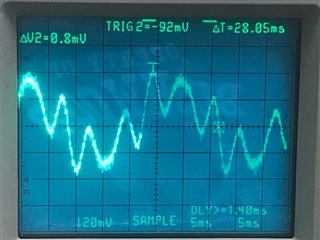

  • I got the current probe for the scope today, here is a trace of one of the phases.  This is at a speed of 1250rpm which is about 1/3 nominal speed.
    I can measure a fundamental current sin wave that is 28ms.
    But then there is an oscillation on top of the sin wave that is about 6 times faster

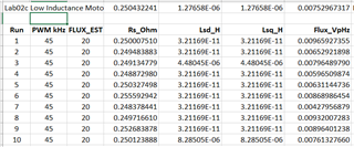

    I ran lab02c several dozen times starting at a PWM of 45kHz and working my way up to 75kHz looking for consistent results.  I also varied the USER_MOTOR_FLUX_FREQ_Hz from 20 to 70 to see if that would help.  Here is a table of the frequencies that worked the best.

  • The TI kit is an older DRV8301-HC-EVM Rev D with a F2806x ISO controlCard Rel 0.4 plugged into it.  The pump is attached to the motor as it is embedded inside the pump.  However, it is not sitting in water so there should be no load on it.
    Using your recommended user settings here are the ID results.  The numbers at the top are the averages of the 10 results.  Note there was one attempt that errored out and those results are not included.

  • At a PWM of 45kHz, if I use anything close to these inductive parameters the project will error with cntrlFreq_Low.  With an Rs of 0.25, Lsd & Lsq need to be above 5.555e-6.
  • It seems like the motor parameters are not identified correctly since the inductance is too small in most cases. I guess the motor didn't run during Ls identification. You have to tune the identification variables as mentioned above, to make sure that the motor runs smoothly during the Flux and Ls identification process.

    I've adjusted these up and down in many combinations.  I can get the motor to run smoothly but when it does  I get the very low (close to zero) results for inductance.  I've also following the instruction in the Instaspin Lab manual on page 72, however those haven't improved the results.
    I've tried a lot of the things mention in the manual below and also adjust variables according to comments in the code.  However, the ID process either fails during the inductive part or the test or the results are way too low to be useful.

  • The identified Flux and Ls should be similar every times if the motor runs well.
    You might try to download the latest motorWare and use the original lab02c to identify the motor again since you are using TI hardware kit, just change the identification variables as mentioned above.

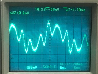

    The interesting thing is I noticed the same jagged current waveform during the ID process as I posted above using my custom board and software.
    USER_MOTOR_FLUX_EST_FREQ_Hz     (20.0)
    USER_MOTOR_FLUX_EST_FREQ_Hz     (40.0)
    As you can see there is the main commutation sin wave that rotates the motor, but then there is a smaller amplitude sin wave at a higher frequency riding on top of that.  It is consistently 5 times (not 6 as I stated above) the motor commutation frequency regardless of motor speed.
    Is this something caused by the motor itself?  My concern is that this is what is causing loss of speed control at higher RPM.  I also believe it is causing the FAST Estimator to report incorrect motor speed.  Using the current probe I can measure how fast the motor is turning and gMotorVars.Speed_krpm is higher by 30-60% depending on speed.
  • What current waveform do you monitor if running the motor with TI hardware kit? Are there any significant difference between the identification motor parameters by using your custom board and TI hardware kit?
    It seems like the current or voltage sensing signals on your custom board are not good for InstaSPIN-FOC.
  • The two pictures in my previous post are from one of the motor phases while using the TI hardware kit during identification.

    I'm getting a similar current waveform on both the TI Hardware Kit and the custom board.  The custom board is very similar in design to the HW Kit.
  • Any load and speed the motor is running at? Do you try to run the other motor with a load at a higher speed?
  • During ID process I was using a bare motor as discussed previously so there was no load on the motor.  During the ID process I used 12Hz which is 20% of its rated frequency of 60Hz and should be around 700rpm.
    The other motor is embedded in a casing with a water pump and is loaded. When I run it at higher speeds it will eventually run out of controller and trip out on over current..
  • So as I look closer at this waveform and how consistent it is regardless of speed and load it makes me believe that it is coming from the motor.  If you measure where each small dip/peak is over the larger commutation waveform (for a given phase) they approximately coincide with the pole crossing points of the other two phases.
    Are these caused by inductive coupling between the phases, back emf or some other characteristic of the this PMSM motor?
  • You might try to run the other PMSM motor if possible, and see what current waveform? Maybe, the BEMF share of your current motor is sinusoidal.
    Or you can try to increase the identification frequency, it seems like 12Hz is too low.
    And then you use lab05b or lab10a to run the motor with the identification parameters, and try to add some load to see what happens.
