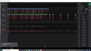

Wanted to branch out this question because it's more targeted, but I am attempting to perform SCI boot (CPU1_RAM config) from a host custom board ("HOST") to a custom board containing the TMS ("TMS").
Per logic analyzer screenshot below, I am confident that I am able to get the TMS (brown) into the right boot mode, as when I'm loading the flash kernel, it reflects everything the HOST (red) sends up until the last few bytes (0x06, 0x00, 0x00, 0x00, which appear to indicate the end of the kernel image).
However, after that point, I can't get any echo, even if I use autobaud characters, as you can begin to see (the stream of 0x41's). I do this for about five seconds, and then I try to send an erase packet (delimited by 0x1B on either side), just as a test, but nothing happens (no response):
Note that even if I send nothing for the 5 seconds and then fire off the autobaud followed by the erase packet, I still get no autobaud.
Questions:
1. Am I not waiting long enough?
2. Am I sending the character (currently 0x41)?
3. Is my baud incorrect (keeping it slow at 4800)?
4. Is my packet incorrectly constructed? Even a checksum error or something like that should be able to return a packet with a status error, no?
5. What other steps can I take to debug my code?

  • Hi Ankur,
    1. 5 seconds should be long enough.
    2. The character looks correct.
    3. The examples usually use 9600, but 4800 should be ok.
    4. Looks like the header and footer have the LSB and MSB switched. The LSB needs to be sent before the MSB. The checksum also needs to include the data sent along with the Erase command. If there are errors during transmission, the kernel returns a NAK. Before that though, if the autobaud lock is not occurring, the packet you are transmitting probably isn't making it to the kernel.
    5. Did you make any changes to the kernel example when using it on your custom board? Were you able to run the example without issues on a ControlCard or launchpad? Knowing what changes were made if any will help pinpoint the issue.
    Anu

  • Hi Anu,
    So I'm able to load what I think is a working flash kernel over UART. As I send data over it, though, the behavior I get back, as shown in the image, is a little strange:
    1) I see the autobaud character echoed,
    2) then I send the packet, 3) then I receive 0xA5,
    4) then a long time later (100ms?), well after I send the second packet, I just get the header byte echoed
    5) ~30-45ms later after the header, I receive what looks like the status packet.
    Is this right? If not, what should I actually be expecting, and what might likely explain the observed behavior on the logic analyzer?

  • Quick Update:
    As you can see, I can now get a status packet with an address of 0x12345678, which according to the document appears to be a good thing. However, I'm not 100% sure how to interpret the earlier part of the packet, after the header and length (0x65 0x00 0x00 0x50).
    Also, what does it mean to get a NAK instead of an ACK as a response?
    Ankur A.
  • Ankur,
    What commands are you sending in the first screenshot?
    In the second screenshot, after the header and length are sent by the kernel, the command and status are sent, this is likely what you are seeing.
    If a NAK is received, it means that some portion of a packet may not have been received by the host correctly.
    Anu
  • Hi Anu,
    Thanks for your response!
    In both instances, I'm attempting to send an erase command to CPU1.
    However, if I'm seeing both a NAK and a 0x5000 for status, that tracks that there may be an error. But then how can I be receiving 0x12345678 for address?
    Also, I don't see how my command is being reflected in the received packet? 0x0065 does not correspond to any of the commands per this document:
    http://file.elecfans.com/web1/M00/00/0E/o4YBAFnLrxKATROGAAYPkh4x3QU718.pdf
    I'm wondering if any timing issues are lingering. Do you have any recommendations on how to sanity check that I configured my clock correctly? Furthermore, do you have any other thoughts on what might be happening?
    Ankur

  • Update:
    I am finally able to get a proper ACK character. The issue was my checksum computation.
    Ankur
  • Further update:
    When I send the DFU command (total length of 10, data length of 0, since data comes after), I get an 0xA5 (NAK). Is my packet constructed correctly?
    Ankur

  • Ok, followup:
    1) I got the control card working. I think there was an issue with how the CC was sitting in the docking station. Because I think it was loose.
    2) I got it working on my custom board, too, by observing how the protocol works in a known example. As it turns out, one needs to respond with an ACK to *every single byte* that comes back after the flash kernel is downloaded and autobaud is resumed, as well as an extra ACK after the DFU response comes back.
    Hopefully this thread proves useful to future onlookers wanting to set up a similar project.
