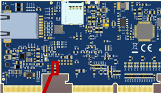

  • On my board there is resistor R43 and the measurement was performed on pin c28x.
    On this pin there is a 25 MHz clock signal.
    The TP6 pin is on the left, in correspondence with the missing resistor (see figure).
    We can make a measurement there too.
    But what does the SW / HW team suggest we do?
