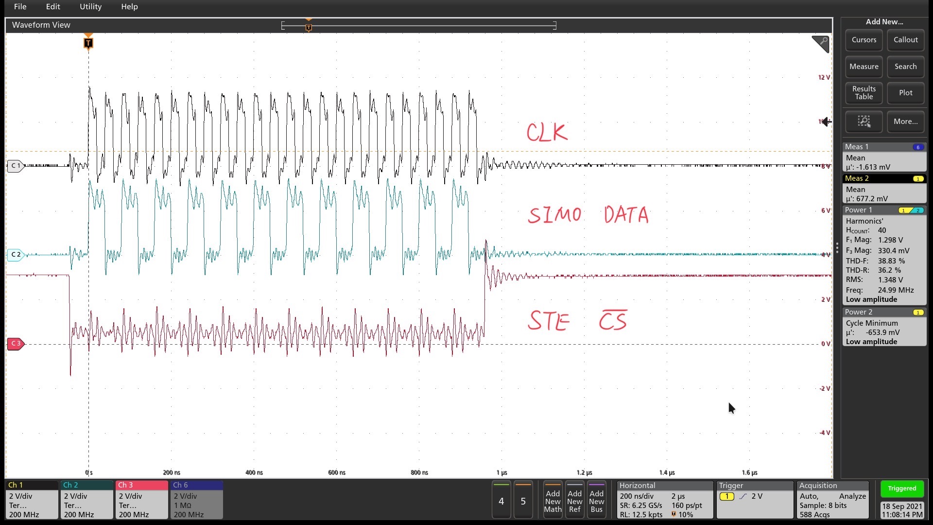

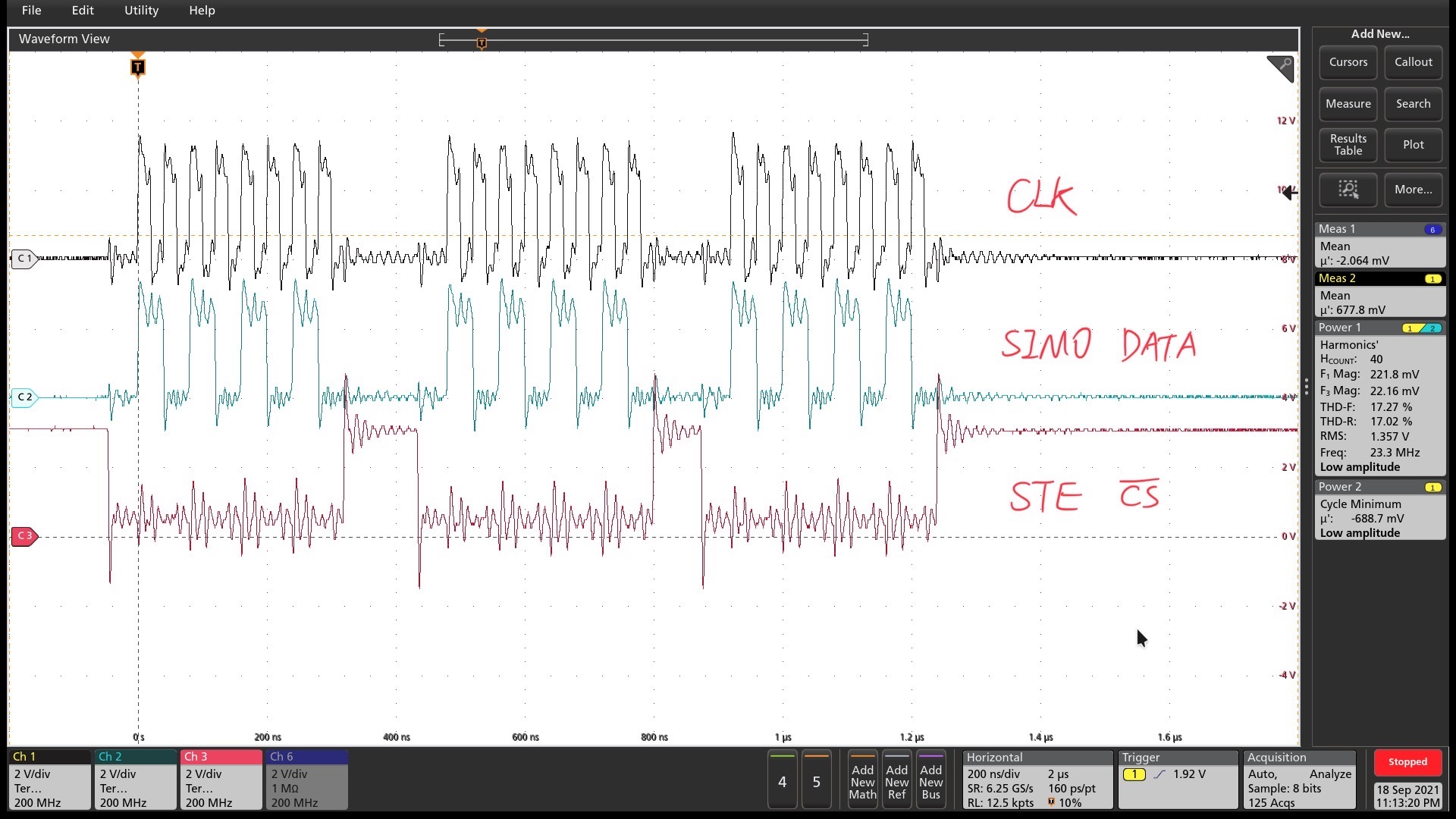

I am trying to use the SPI module of LAUNCHXL-F28379D to communicate with a DAC81408. Since DAC81408 requires input data with 24 bits, I configure the output of the SPI module as 8 bits and plan to continuously output three sets of data to control the DAC81408. The system works well when I download the code to the RAM of TMS320F28379D. However, the system fails if I download the code to the FLASH. I find the problem is that the SPI module can not output continuously when I download the code to FLASH.
The following is my SPI initialization code.

Then, for testing, the following code is executed in the main loop to output three sets of 8 bits SPI data.
    SPI_writeDataNonBlocking(SPIA_BASE, 0xAA00);
    DEVICE_DELAY_US(50L);
Now, if I download the code to RAM, 24 bits 0xAAAAAA can be continuously outputted, as shown in the following figure.
Then, if I download the code to FLASH, the output is just three sets of 8 bits, as shown in the following figure.
Thus, may I ask what should I do if I want to continuously output n sets of 8 bits SPI data to form a set of 8n bits data when downloading code to FLASH?

  • Hi Jony Wong,
    If you have configured the STE pin to be controlled by the SPI module, it is pulled high after every transfer. Looks like, in case of RAM, since the instruction fetches happen faster, the next send instruction happens before STE is pulled high.
    I would recommend you control the STE pin by software. You can configure the pin as general purpose output pin instead of SPI_STE pin and pull it high or low using the GPIO data register. You can refer to the SPI EEPROM example available in C2000ware as reference.

  • Hi Veena,
    Thanks for your reply. I will use a GPIO to control the \CS pin for stability.
