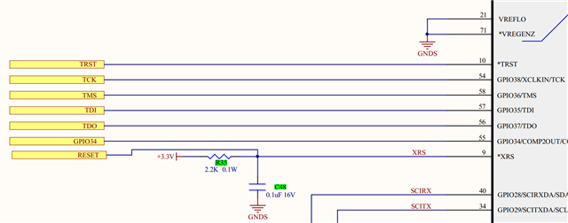

  1. our control cards don't have a JTAG locally mounted, so whenever the DSPs are frozen, right after I connect the JTAG they go back to normal operation!! the LED starts to blink and it seems everything is going great, also as long as the JTAG is in-circuit the code never fails...
  2. I tried to use our Watch-dog and the point is the Watch-dog whenever the failure occurs keeps resetting the board, but it can never recover it back to normal operation until I fully recycle the power ( we are using software watchdog not NMI)
  3. on our board, we don't have the GPIO 34 or TDO pulled up externally. ( I checked, even with external pull-ups there is no difference and it seems the issue is not the boot mode selection...)

      1. Please double check the power sequencing of the design against the data sheet requirements
      2. If you wait longer between power down / up is the behavior different?
    7. What is the boot mode?
      1. You mentioned TDO and GPIO34 are high so you are using get mode?
      2. You mentioned external pull-ups on TDO/GPIO34 do not change the behavior.
    8. Is there any temperature dependency - i.e. does the behavior get better or worse based on ambient temp?
    9. Does a device that fails feel "hot" or warmer than one that is working normally?
    10. Does the problem follow a particular device or a particular board?
      1. You mentioned a potential serial number tie
    11. Please double check the device errata for any issues that may apply to the specific design.
    12. You mentioned checking clocks and power.
      1. double check to make sure there is no power droop before the issue is seen.
      2. check power-up sequencing against the data sheet
    13. Does TRSTn have an external 2.2 k ohm (or less) resister?
    Yes, it has a 2.2k tied to 3.3V with a 0.1uF CAP on the XRS pin.

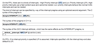

  • John,
    The code is nesting interrupts - this is done by the code at the start of the ADC ISR - it is enabling lower priority interrupts to be serviced while the ADC ISR runs.
    The reason I asked about this is there are some fairly strict guidelines for nesting interrupts and if they are not followed it can cause issues.  Since the behavior you see is related to the rate of interrupts this is a path to follow and see if it yields anything.
    Refer to
    In particular this caution:
    I'm wondering if the code void enableADCInterrupt1(void) may be called somewhere outside of an ISR.
    Adding an interrupt handler for every interrupt can help to catch this problem if it is happening and also keep the PC from going into the weeds.  In particular interrupt 1 in each group (i.e. INTx.1) interrupts can be triggered even if not enabled or used.  It can be one actual ISR that all the unused vectors point to.  This is what our examples do in the default ISR setup routines.
    Lori

  • -TRST needs to be connected to GND thru a Pull-down resistor (not to 3.3v). Would you be willing to share your schematics offline?
  • Hi Hareesh,
    Thanks for answering, My board for this part has a simple connection as below:
    so all the JTAG Pins are going out without any pull-up or pull-down, the JTAG board is separated and it has all the pull-ups and downs as offered by standard TI designs.
    so this board, once operating Standalone, all the pins are left open, and as I said earlier the boot up is fine mostly, and sometimes it fails in run time after activation of some interrupts within the code...
    so you think the problem is the pull-down on TRST? if that's the case how come the code boots up safely like 80% of the time and fails in the other 20% during the run time after lots of initializations and so on?
    John
  • You do need PU resistors on the boot-mode select pins. These pins have an internal PU, but they are weak. Any noise on these pins during power-up could put the device in some other boot-mode.
    Similarly, the -TRST pin also has a weak internal pull-down. It is highly recommended this is supplemented by an external 2.2K PD.
    Depending on the noise situation, your board may or may not power-up properly (without the external resistors I suggested). These resistors must be connected to the device pins all the time.
    To isolate the problem between H/W & S/W, please try this experiment: Program a simple GPIO toggling code into flash and see if the poser-up is good every time.

  • John,
    Something to check on the software side.  The compiler defines two types of interrupts - a high-priority (HPI) and low-priority (LPI).  Please check that any interrupt which has nesting enabled is not defined as a high-priority interrupt.
    You can search the codebase for the term HPI.  A high-priority interrupt will have a one of the specifications shown in this screenshot from www.ti.com/lit/spru514 the compiler user's guide.  An interrupt defined as HPI has a faster context save, but does not allow for nesting.
    I doubt this is the problem since it should manifest with CCS connected as well.  But it is worth checking for.
  • Hi Lori,
    Thanks, yes, I checked and nowhere in our code, the mentioned HPI or LPI assignments are used, so it seems this can not be the issue.
    John

    • Case A: 3.3v, 1.8v, -XRS, -TRST
    • Case B: 3.3v, -XRS, the two boot-mode select pins
    Still awaiting the waveforms.
